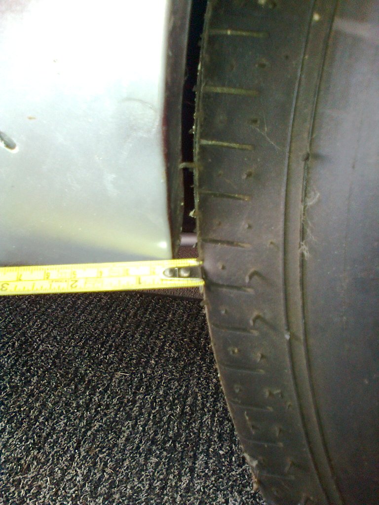

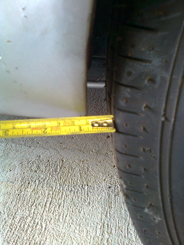

Bit of a clean, sorting through a few little jobs, not quite ready to get stuck into anything serious but just nice to have it home.
1st task was to sort the rear tyre to front-of-arch clearance. I simply wound the axle back 3 turns on each of the 4-link bars and bashed the arch flange a wee bit.
tyre clearance after.jpg (168.72 KiB) Viewed 1750 times
tyre clearance before.jpg (162.92 KiB) Viewed 1750 times

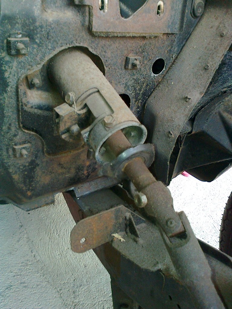

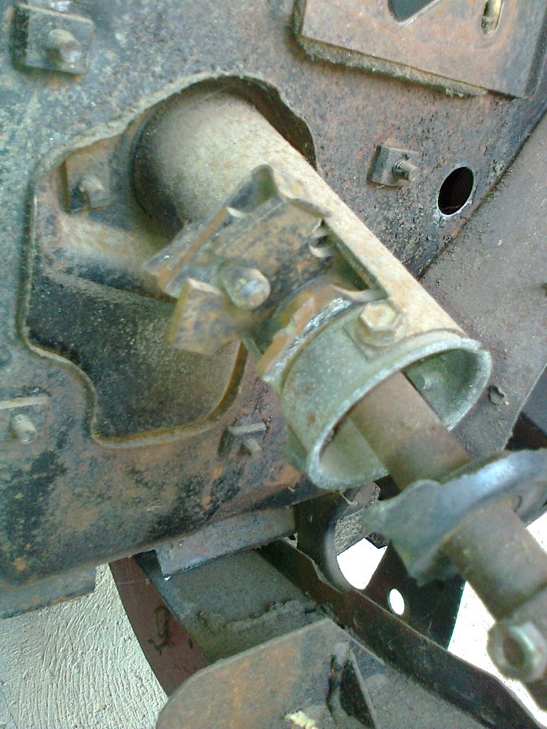

Posts: 8368
Can anyone tell me what's missing here? I've looked on Year One and there's a bewildering array of bearings, dust shields and doodads!
Help!
Posts: 22140
Bottom bearing is missing - it' like a big rubber doughnut....
Posts: 8368
Thanks, i'll investigate... :read2:
