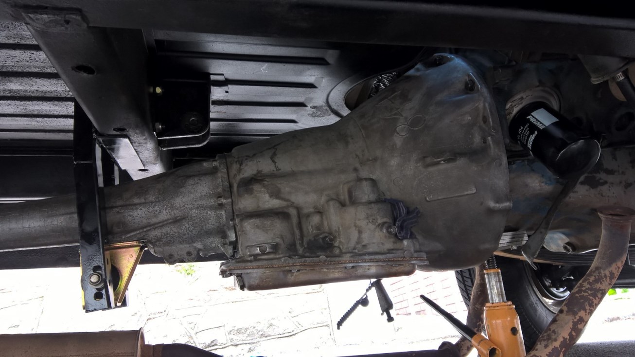

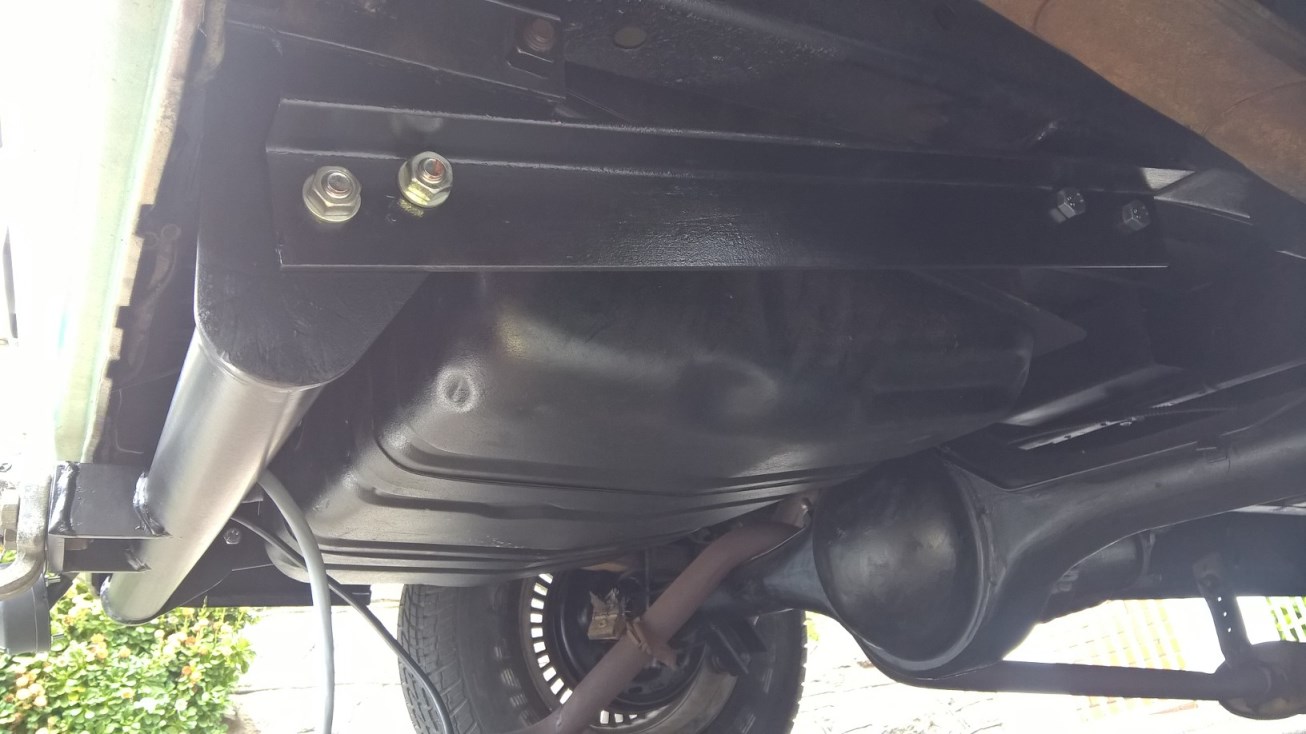

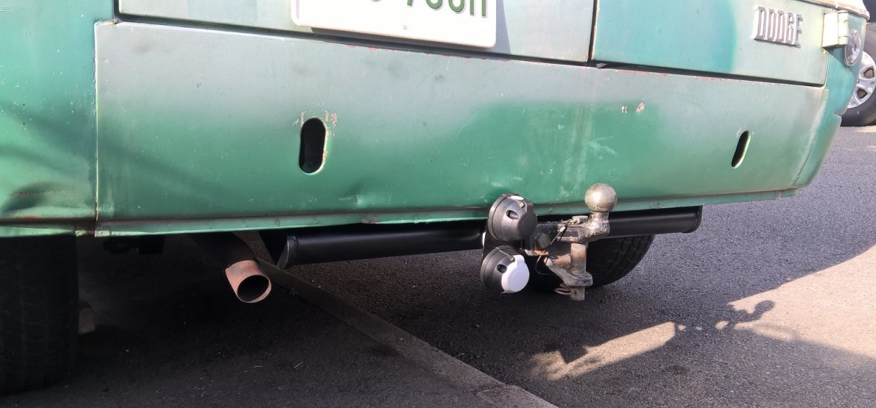

Lots done lately! :D
Rebuilt trans back from Dunc with splined tailshaft & casing fitted. New trans mount finished and trans installed.
Front brakes overhauled with all new hardware and all fluid flushed through- no more swamp water!
Towbar completed, painted and installed. Cables run inside van but not wired up yet.
01 Towbar fitted.jpg (197.15 KiB) Viewed 3963 times
02 Towbar struts.jpg (184.51 KiB) Viewed 3963 times
Rebuilt trans, new mount.jpg (222.46 KiB) Viewed 3963 times

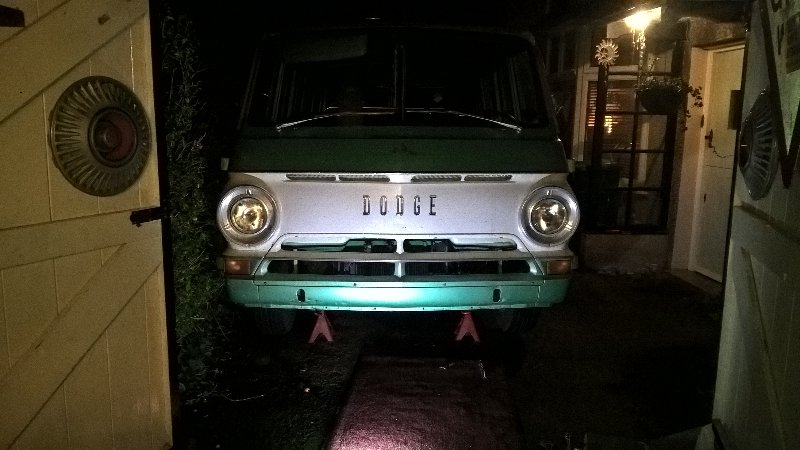

Right, lets try out the new photo facility 😊
So the first is the Fiesta van up my road I got a little too close to one night. Needless to say it's a write-off but there's not a mark on the bus. These A108 door hinges are pretty brutal :D

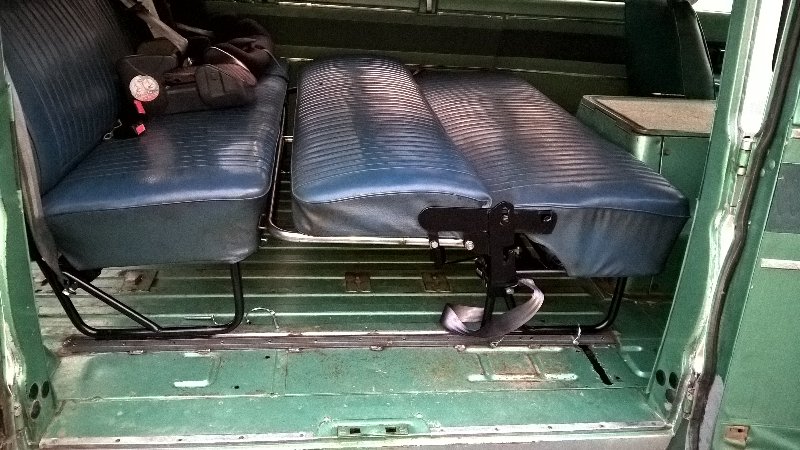

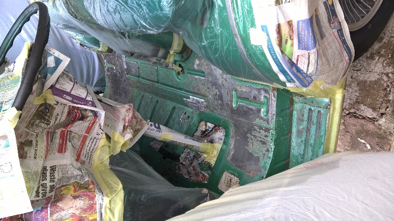

The new seats are fully operational. They're a bugger to move as they're damn heavy but they do work.

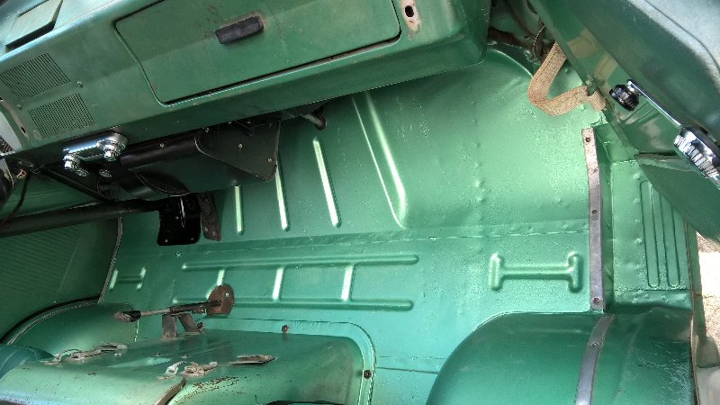

I've painted the front floor, looks lovely!

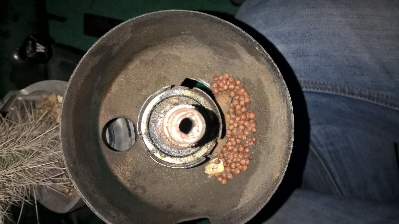

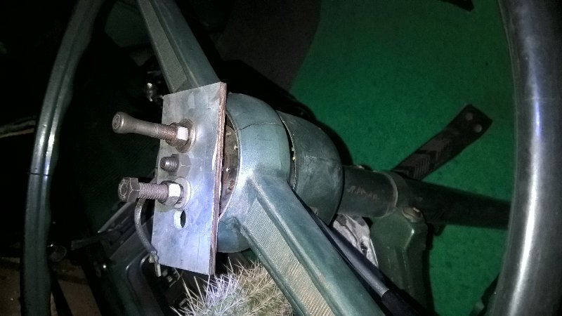

Steering wheel is off thanks to my little home made puller.
I just found a little stash of seeds :lol:

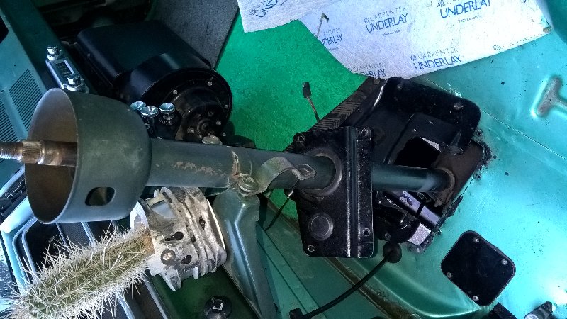

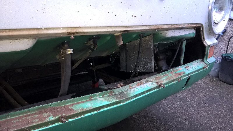

It was touch n go whether the grille was coming off- The 4 big X-head screws took as big a beating with the impact driver as I dared! It's not essential for removing the steering but I'm glad I persevered, I've exposed some rust prevention opportunities!

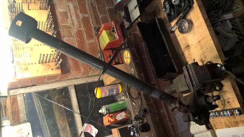

Separating the column inside the cab is just a bunch of screws to remove the floor plate and two bigguns to release the top clamp.

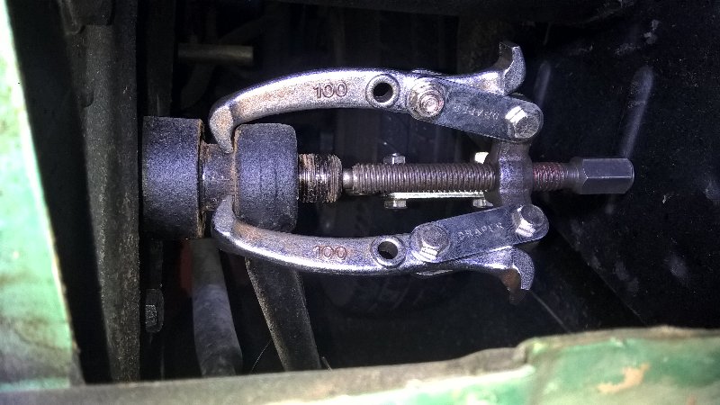

I dug out my 3-legged puller with a ball bearing as an adaptor to pop the steering arm off
Two more bolts (the 3rd was missing and those 2 weren't as tight as I'd like!) and the whole lot lifts out through the floor. Loosen the u-bolt and the tube slides off the shaft.
Next step is to clean it, drain it and open it up!

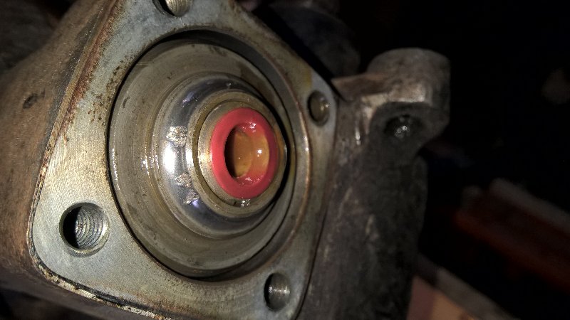

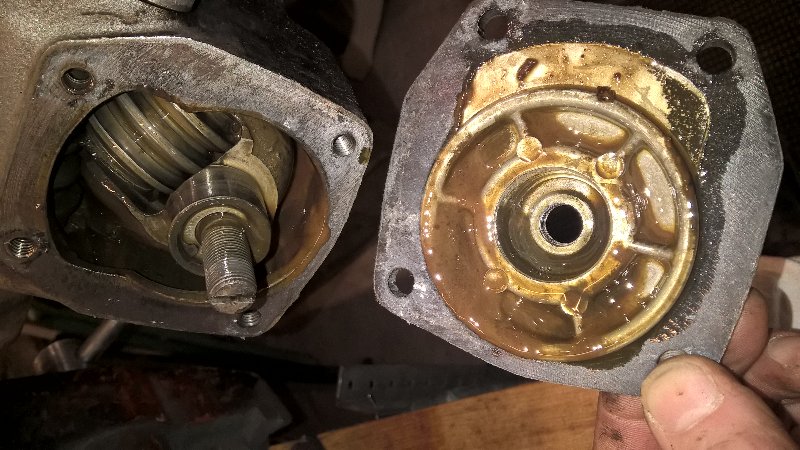

I've now cleaned out all the swamp mud and found nothing broken, which is nice! The only damage is some heavy pitting on the bearing race on the end of the steering shaft.
Posts: 14424
Re: db's 1970 DODGE A108 Sportsman van
Might get away with a good clean and a new bearing?
