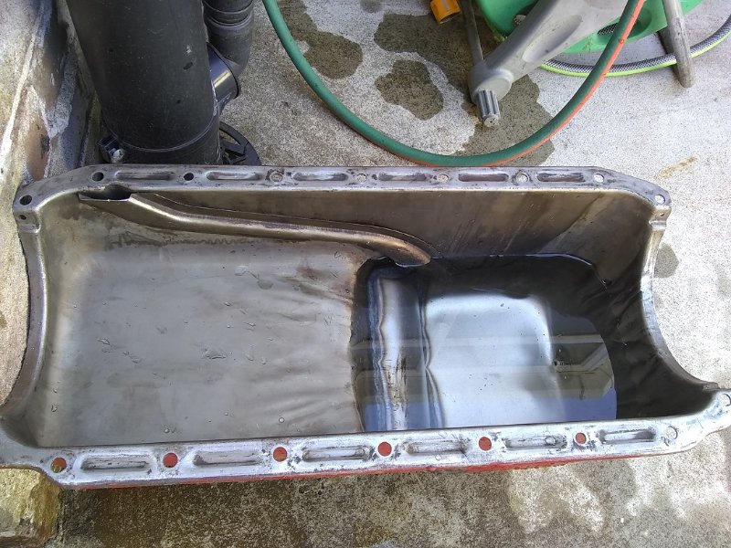

Pete wrote: Thu Jun 18, 20 9:52 pm Fantastic work, but watch out for reduced sump capacity - that is what saw off the 396ci BB motor in my '57 Che*y....
I did think about that, and adding wings to the rear of the sump to compensate, but when I put in 8 pints of water to test for leaks . I don't seem to have removed that much volume capacity :thumbright:
I will however have to re calibrate dip stick measurement :?
From what I have read, the 318 takes. 5 US quarts = 8.2 UK pints. With the galleries and the Oil filter .
I should be OK :-k ?

mygasser wrote: Thu Jun 18, 20 10:41 pm
maybe add a bulge to each side to compensate, although myself i probably would've notched the rear of the subframe and left the sump.
"maybe add a bulge to each side to compensate"
This was something I had in mind , if the above immage didnt work out OK :thumbright:
I do want to take a little out of the subfrome also, for ajustment :thumbright:

The alternative is to do what I do on the race car, which is to over-fill it by 1 quart when static.
I put 9 quarts in the Challenger.
5 quarts still sounds light to me.
Once the motor is running, there is more oil in the top end than there is in the sump!!!

TIB3300 wrote: Fri Jun 19, 20 6:20 am
looking at that pic i'd definately add a 2" wide-ish horizontal plate across the front of the sump 'well' with just a small cutout at each front corner of the plate for drainback. this will stop the oil sloshing forward under braking and uncovering the pickup. if you can make the plate a 'u' shape so it covers the sides too without interfering with the pump/pickup even better. as long as the plate isn't higher than the front/shallow part of the sump then you will be fine with crank/rod clearance.

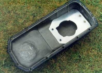

You mean something like this?
Posts: 14582
Re: Cortina MK3 V8 MOPAR
I don't think you've removed much volume either, unless you're going to be screaming the nuts off it I wouldn't be too concerned. Good call on limiting slosh though, if there's room you could add a plate over the sump area with a big hole in it for the pick up to pass through and some gaps around the edges to allow for drain back.

and re the pic with the yellow bit yes but more. as blue says if you can do a complete cover with just a hole big enough for the pickup to fit through that'd be the best. the more you can keep what oil is in there around the pickup the better.

I will make an internal baffle with a hole in it, I will get it approved by you guys befor welding it in
iIle make somthing like this :thumbright:
that baffle design will be spot on mate :thumbright:
