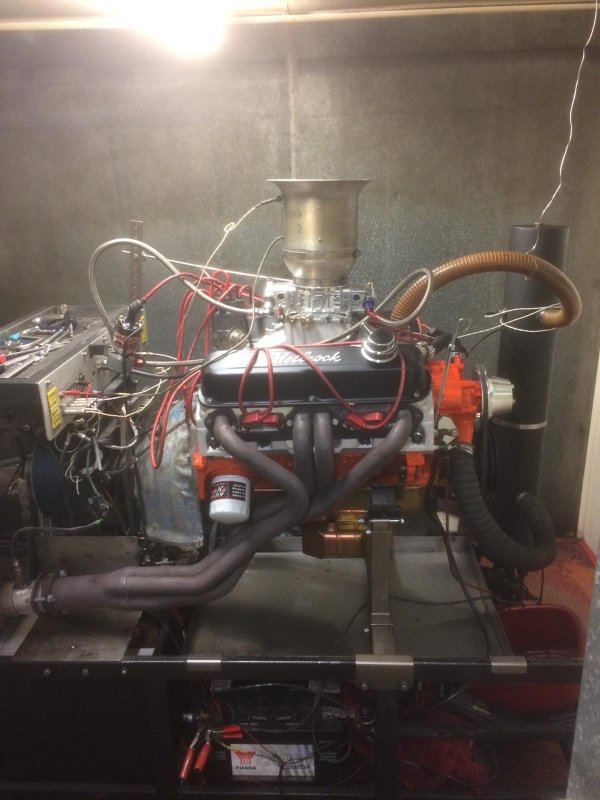

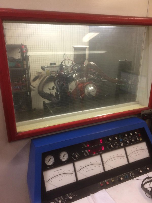

pics of engine on Dyno courtesy of Dave Billadeau .

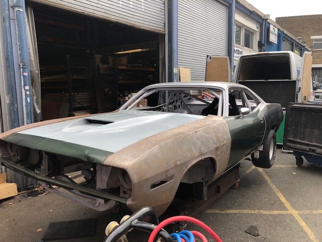

Bodywork - outer panel final test fitting .
Re-bushing door hinge pins

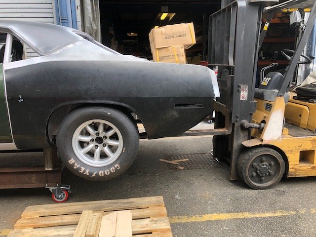

Outer panels fitted . I was fortunately able to buy a pair of used front wings in the UK. One of them needs some straightening but they're ready-blasted, and very solid. Rear part-quarters still to be finished - one came with the car and is reasonable quality, one is AMD and is good.
The AAR Hood is just laid in place for now. It came from Stinger Fibreglass in Florida and is very nice in terms of fit and finish.

EDA I presume? Looks familiarMatt wrote: Thu May 09, 19 10:45 am Meanwhile, somewhere up North
Thanks again to Dave Bishop for lending me his Moroso oil pickup so I could get the engine finished. The part now appears to be in stock at Summit so should finally be with me in a few days.
That’s EDA’s dyno, been there myself a few times over the years, last time with Gavins 440. Great bunch of guys and true honest dyno results. Great work Matt and good to catch up with you at Wheels day on Good Friday.
