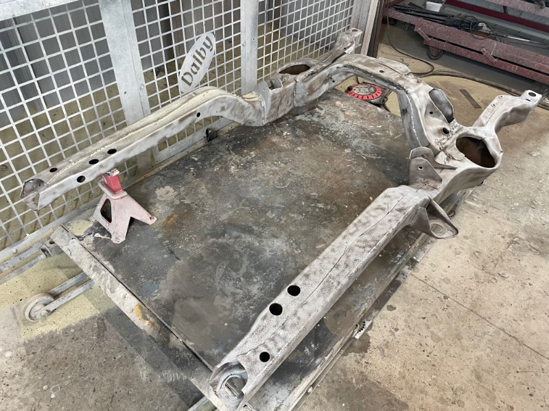

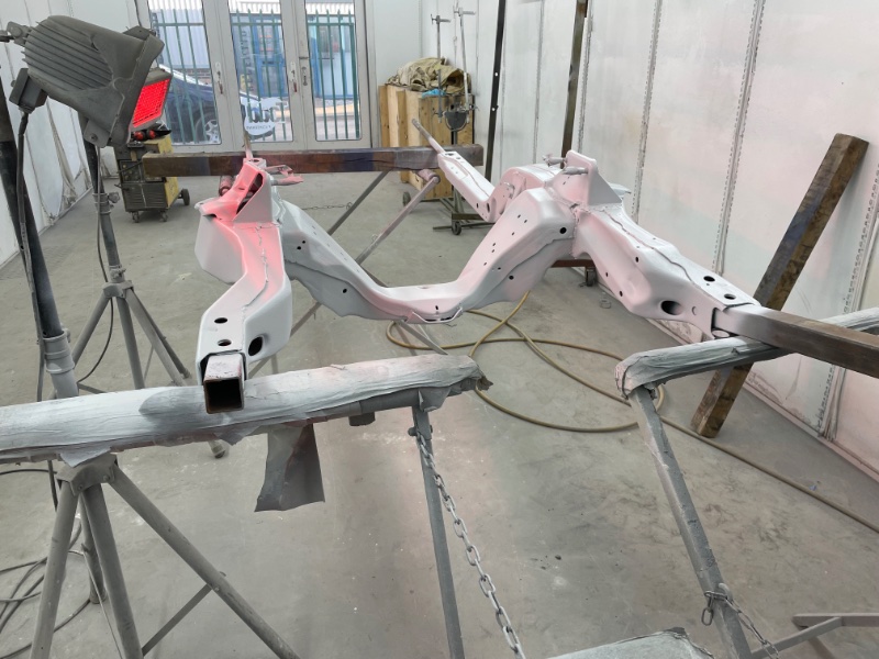

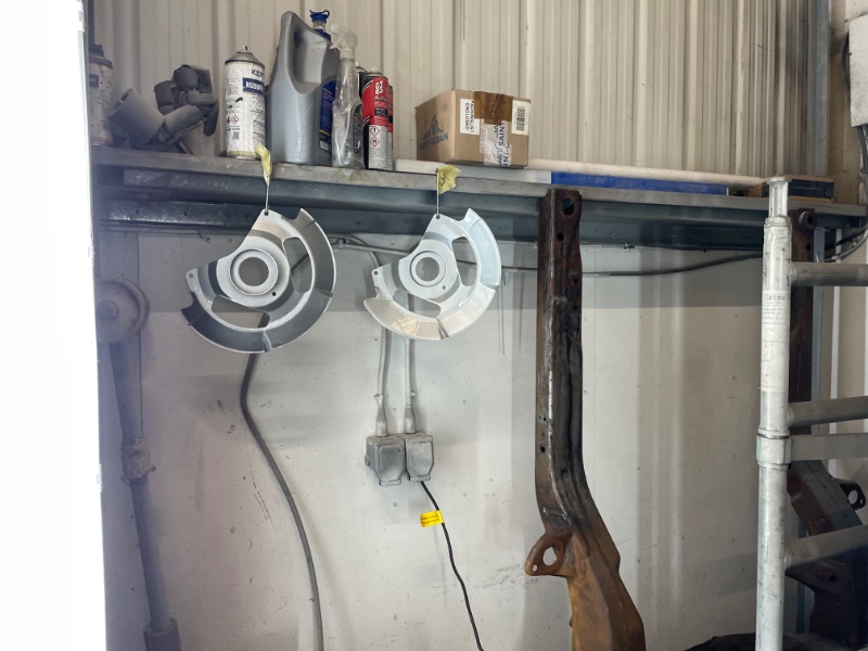

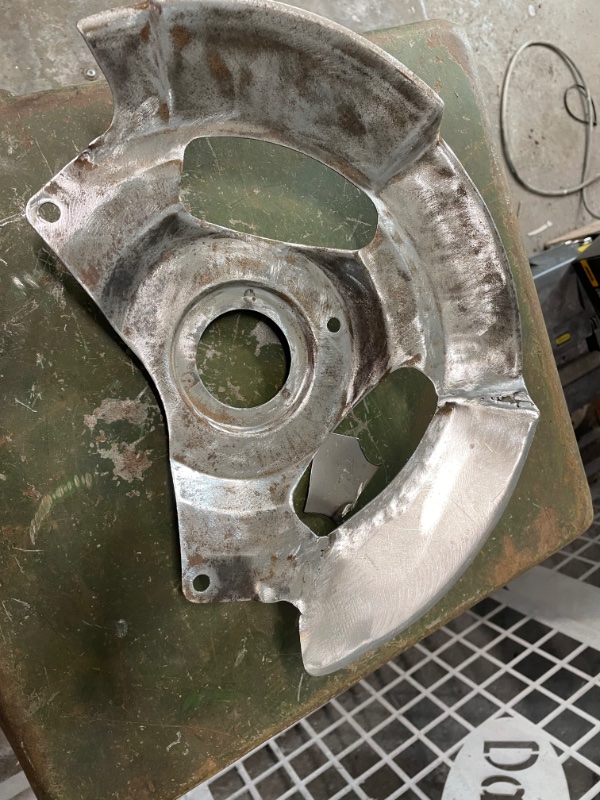

Very little progress unfortunately due to the cold still,
Apart from a few hours underneath, just Hav’nt got the enthusiasm and my shoulder/Bicep damage is causing me some issues!

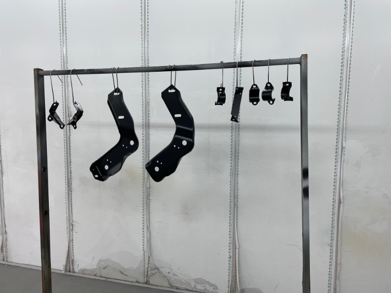

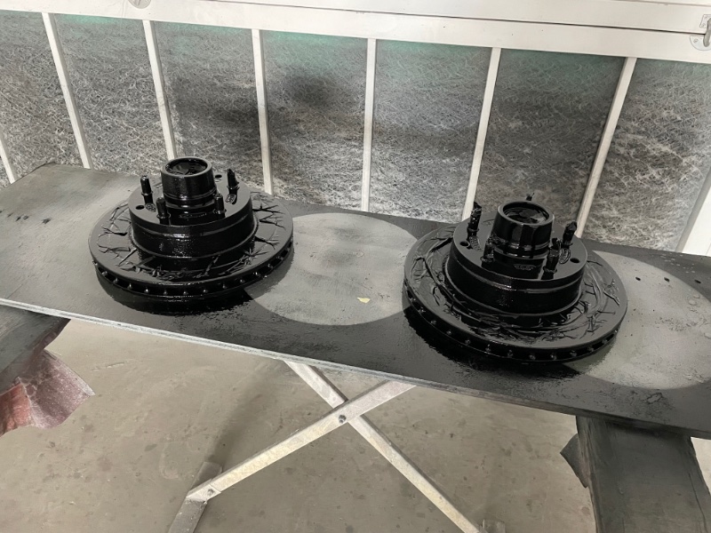

I have however been able to get other stuff done at work,
Drums disc’s spindles etc, and made a start on repairing my radiator support as these still aren’t available and JEGS finally refunded my payment for the one I had on order,
I’ve all but given up on having it done this now so working on 2026 ,
Saw my consultant on Friday regarding possible procedures to repair the damage, but he said it wasn’t a good idea,
Zero guarantee of any significant improvement and lots of time recovering, so basically I’ve got to live with it now,

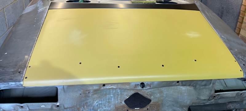

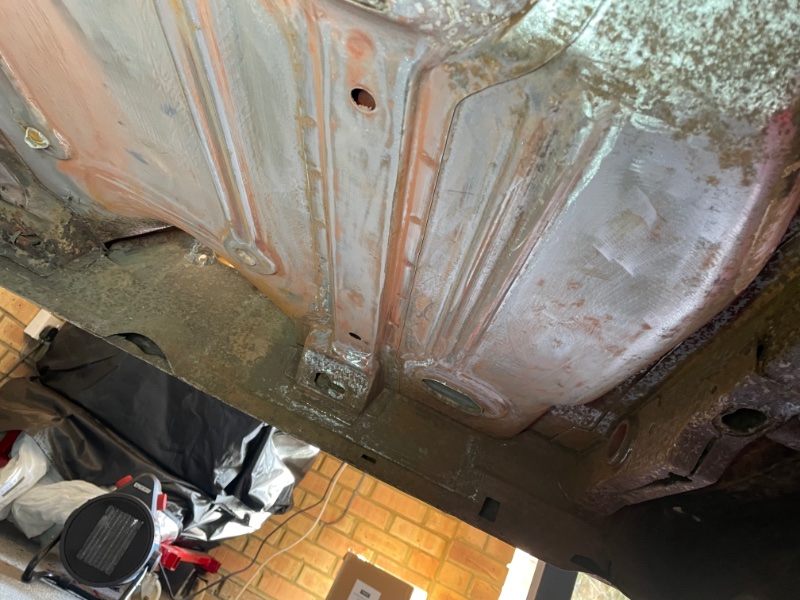

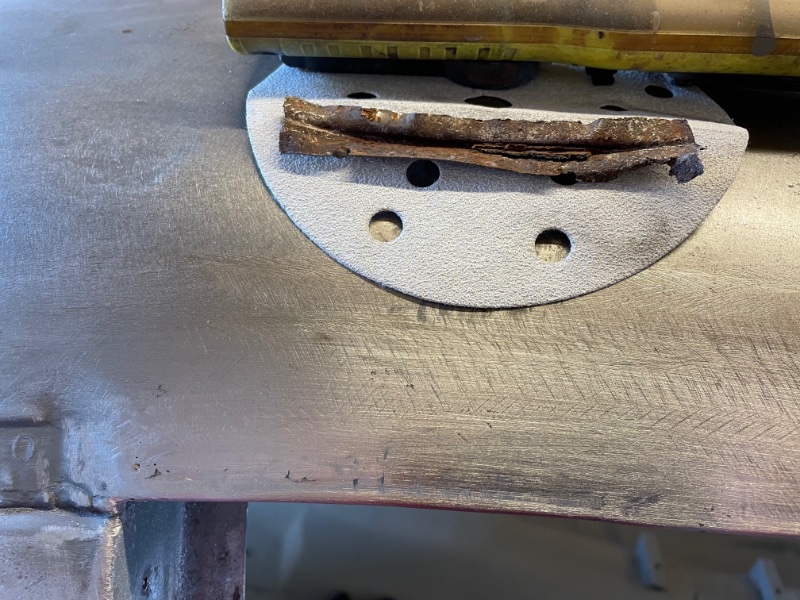

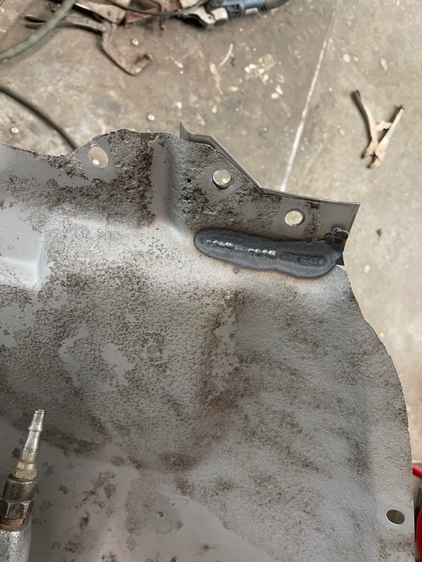

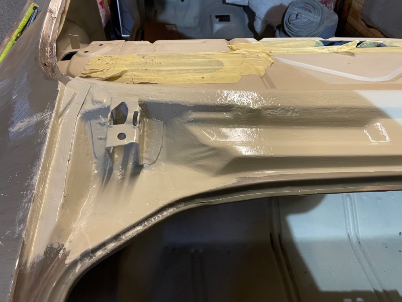

Managed a few hours on the TA, some at work getting more parts into colour and started to repair the Deck filler panel on the shell,
This part has suffered some rust damage and would hs e been replaced it I was fitting new rear quarters,
However my quarters are not bad so I’m having to repair the deck panel
I’ve a new deck filler panel to fit so 90% of the underlying area is invisible once the filler panel is fitted so I just need a solid water tight and rust free repair,
I just applied the epoxy by brush just to keep it all clean and dry, most of this will be removed once I start the finish process

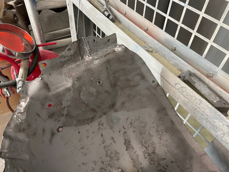

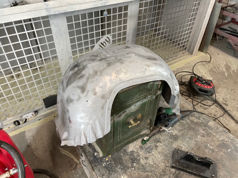

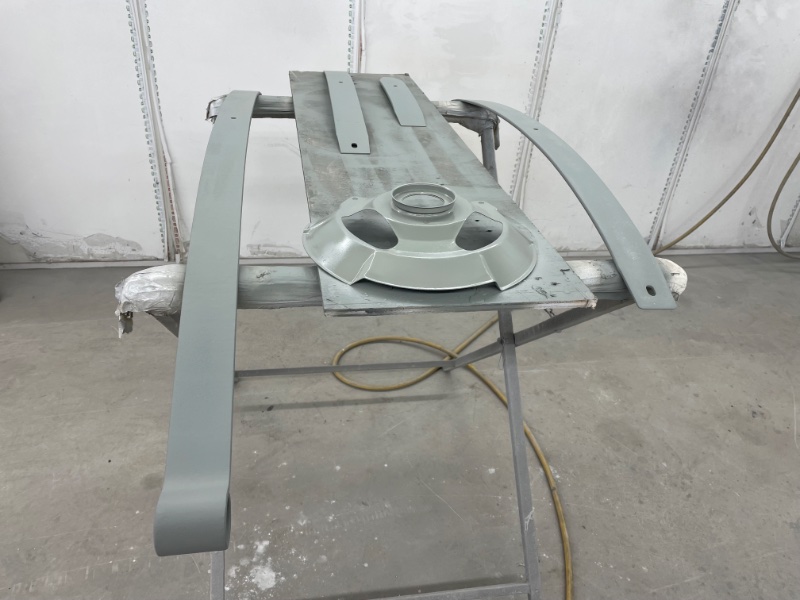

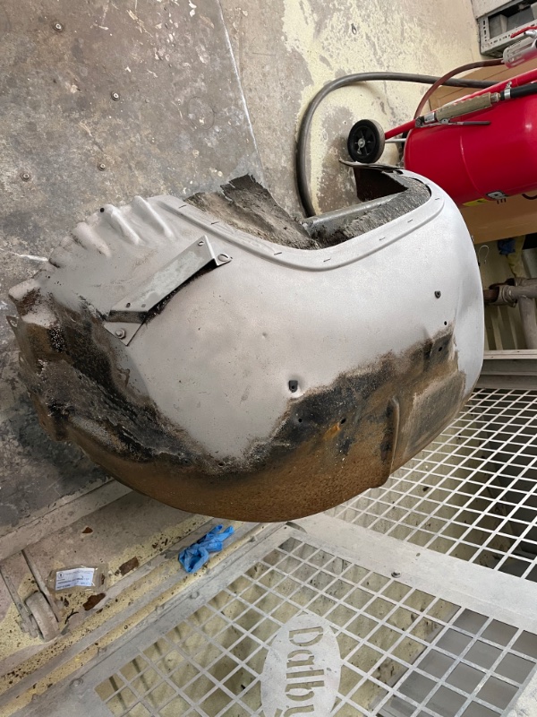

Managed a few hours this week on my Wheel houses,
Now these looked a bit sad and scruffy with a fair amount of corrosion pitting, but being where they are not surprising !
Any way I’ve blasted them and then used Ferro Bet acid to remove any rust spots etc, one had a couple of bits that needed replacing, so made a pattern and welded them in
Should get them in primer next week.

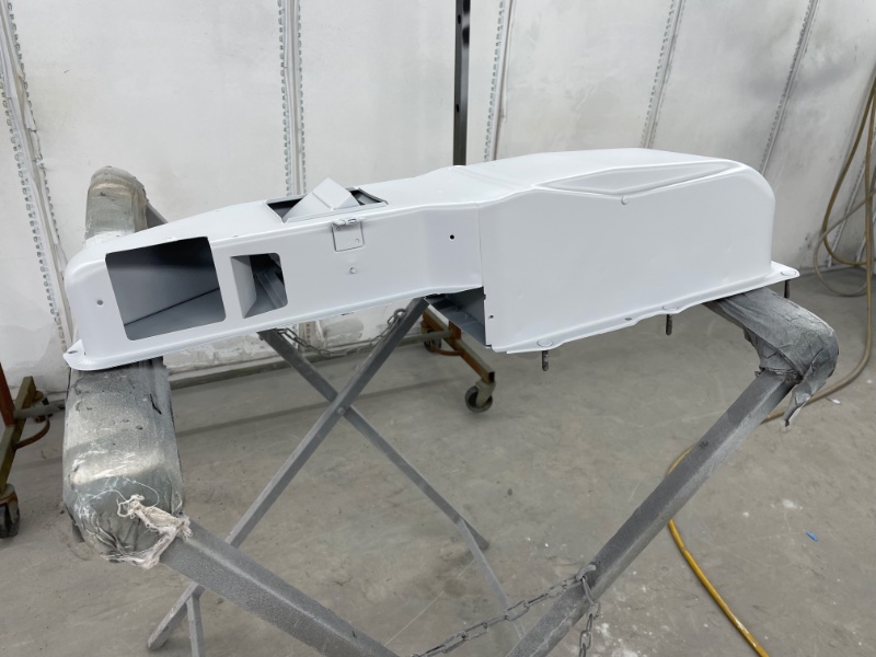

Next up will be the front subframe, and Radiator support, hopefully it will warm up a tad so I can finish the rear deck work,

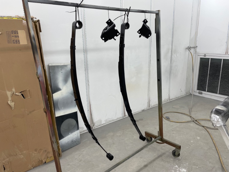

My parts to do box is definitely getting smaller,
Just the front control arms and the suspension is done,
So apart from some odds and sods the heater box assembly is the last big piece to do,

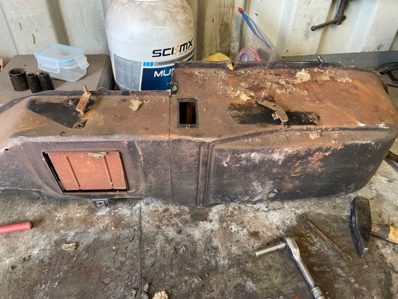

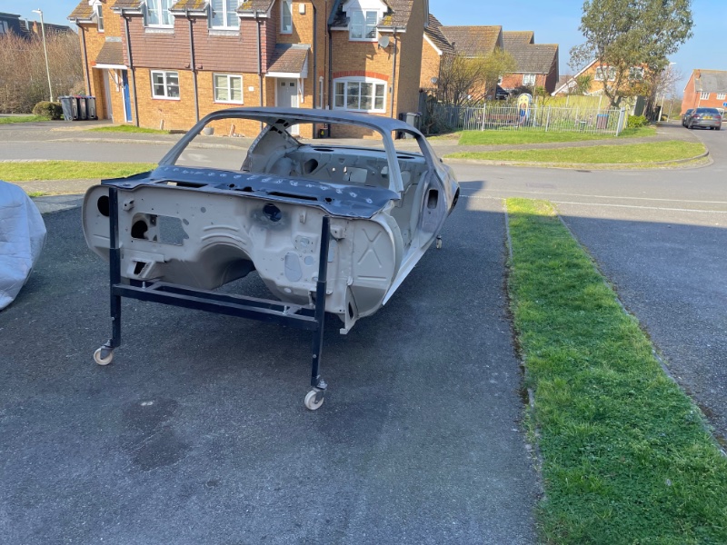

Managed to get the rear deck completed today
Still got some corrosion to remove from the rear window aperture but still heading in the right direction!

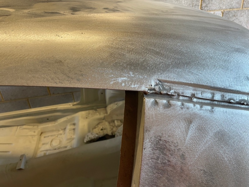

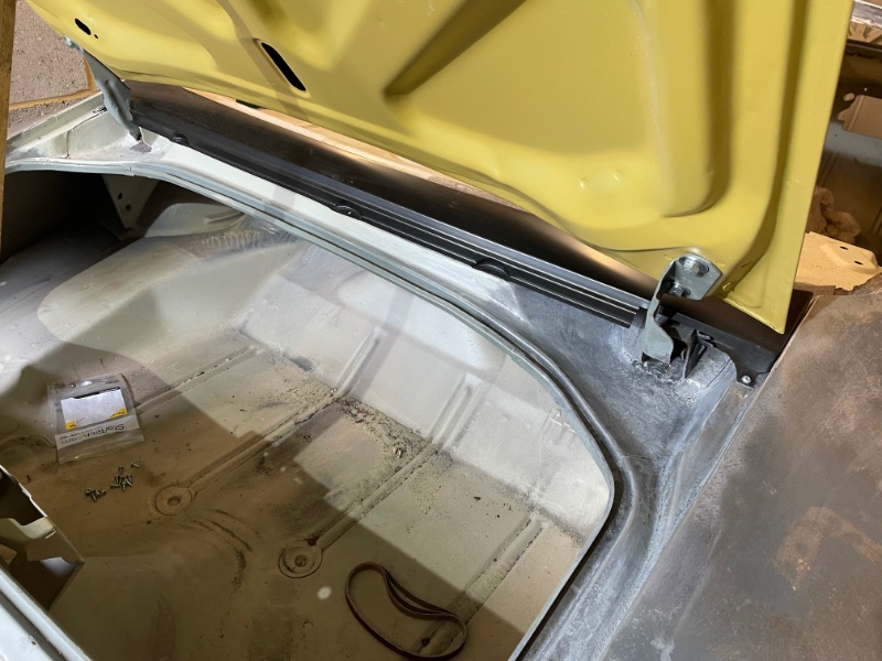

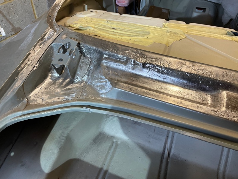

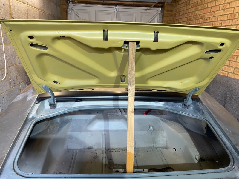

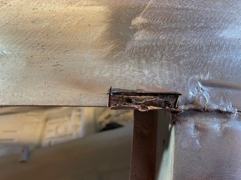

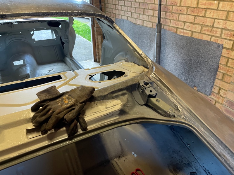

So finally finished the rear deck,
Been doing some annoying corrosion to the rear screen aperture,
Also had some corrosion to the edge of the roof where it joins the sail panels,
Also been refurbishing bumper brackets etc at work so still moving forward!

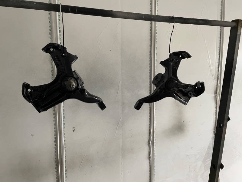

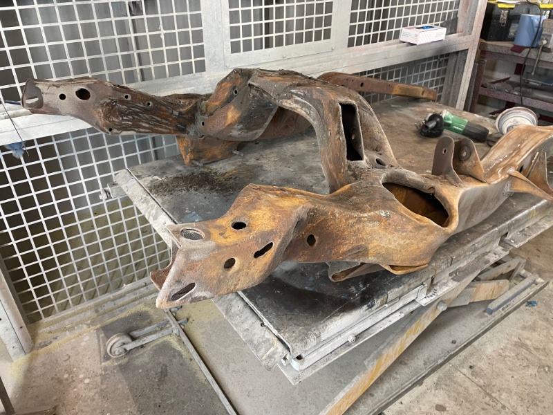

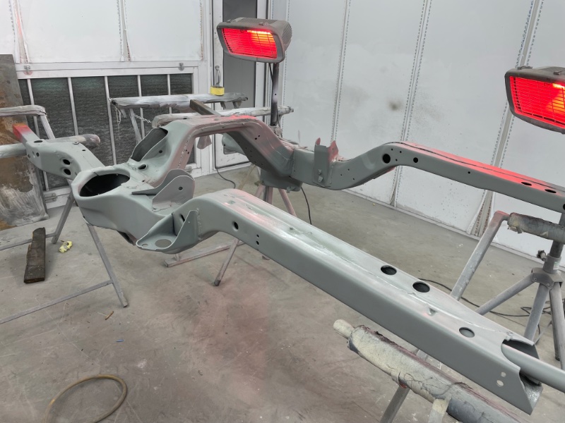

Ok so another busy week,
Finding it hard going at my age , 6 day weeks now for 7 months!
But I feel it’s worth the extra effort, I can relax when I retire!

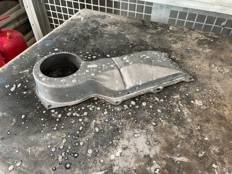

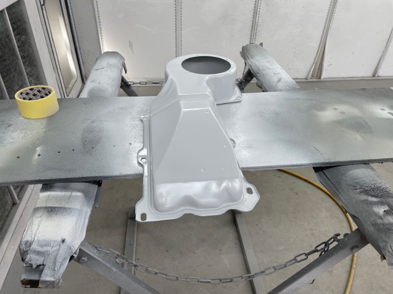

Mostly been doing the front subframe, blasting and cleaning for refinishing,
I was going the epoxy it but once fully cleaned it was so good, a Coat of Eco Phos etch , and then 2k urethane was a better choice,

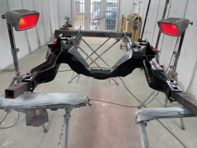

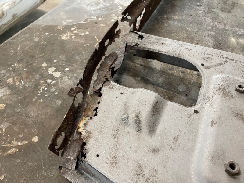

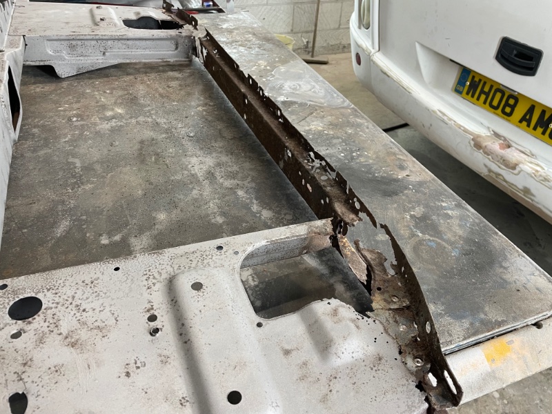

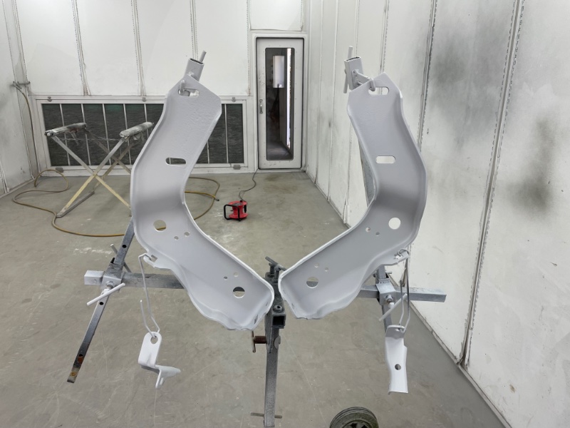

Managed to get the frame in colour
Now repairing the radiator support, the lower beam was quite rusty and since I can’t get a OER or a Dynacorn replacement , so thought I’ll refurbish my original one,
Pig of a job due to the very strange shapes !

So hence the repair,
One way or another it will help with the general progress for front end alignment and panel work,
And if a replacement does happen I can Bananarama! and fit !
Thanks son, I wonder sometimes all this a a tad tedious!
I’ve got a support on back order but absolutely no idea if/when they’ll return to stock?
