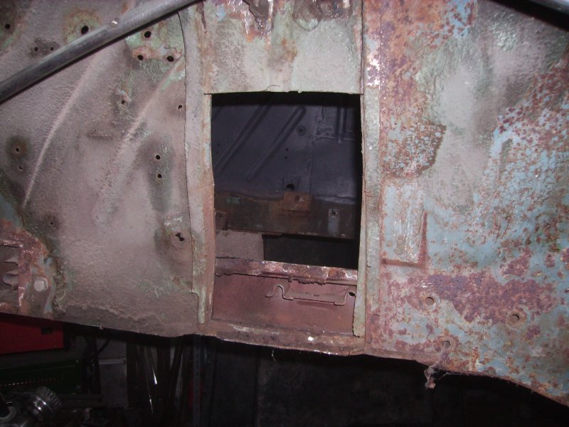

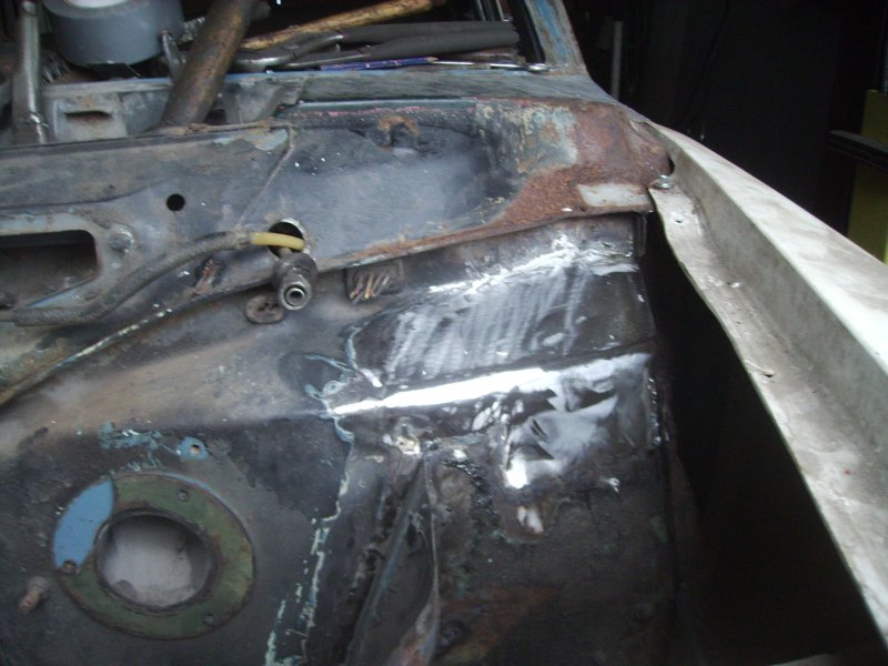

anyway... we've done some more surgery today cutting the other inner wing top etc away. the lower part between the 'cradle legs' hadn't been repaired this side so that's gone too. we'll trim it back fully then offer the templates up from the other side, the drivers side has a recess to clear the servo so a little different there for sure.

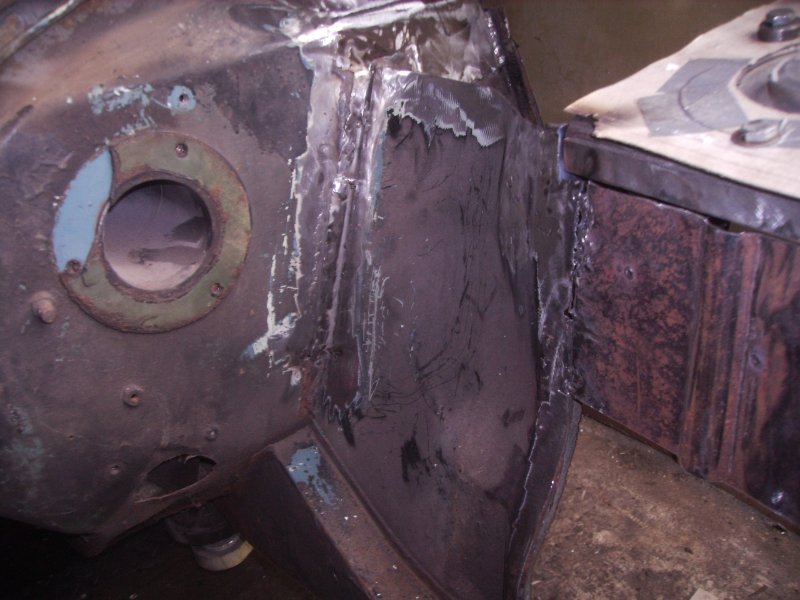

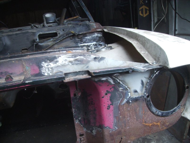

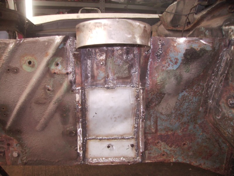

we've been trimming some more rot today on the zephyr, first at the bulkhead to inner wing and also at the inner wing to front panel. the large o/s inner wing template looks like it'll work once flipped over for this side which is good. then we did some more cad work for the bulkhead to inner wing areas.

Posts: 1675
Re: a bit of this and a bit of that
those templates are now transferred to steel and welded in place. too late for grinding so pics tomorrow. :thumbright:
