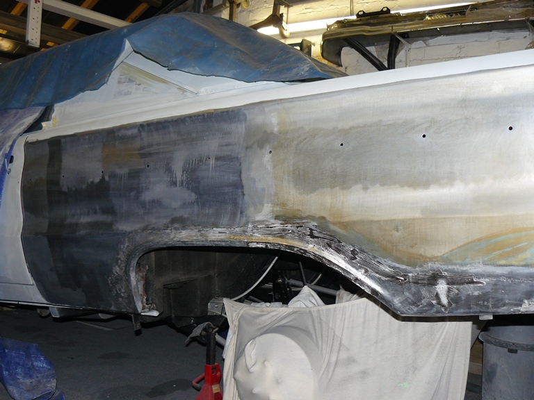

I've finished welding the outer skin now. I've zinc sprayed it too.
More pics to follow once I've persuaded my camera to let them go...

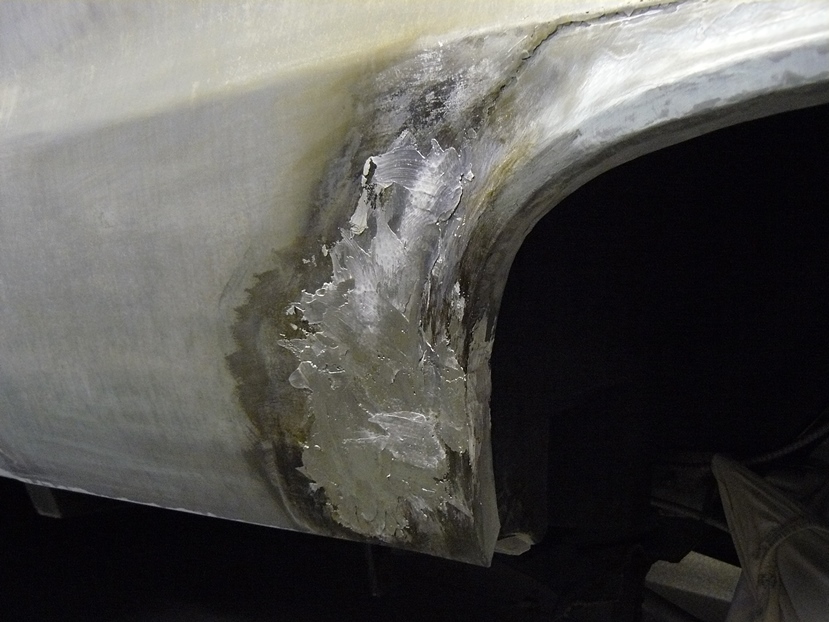

I had to weld in this little slice of metal to correct a minor cock-up :roll: But I'm happy to report you can't even see the join now :thumbright:

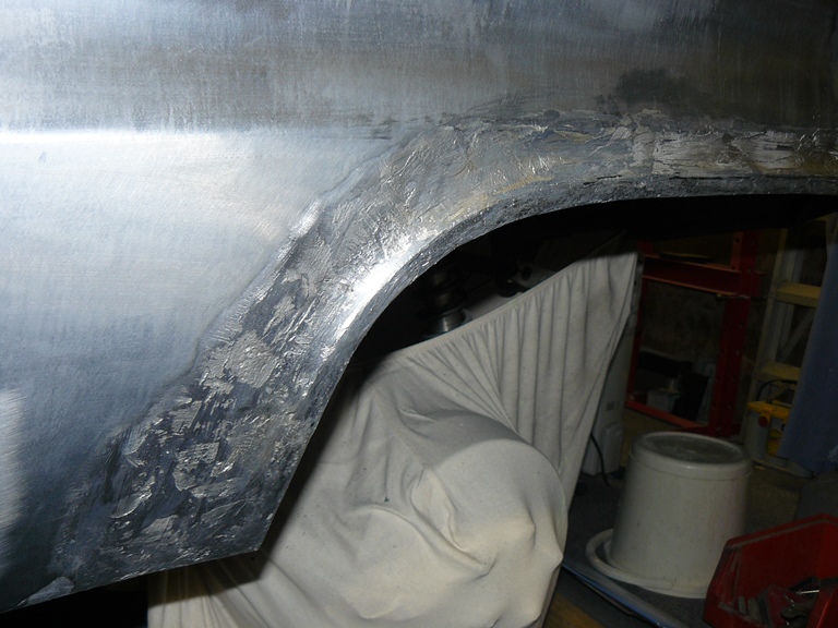

I've laid on the first bit of lead this evening, very satisfying :D

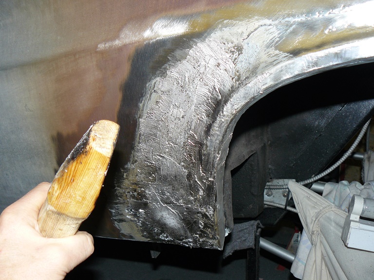

So, that was a fine example of how NOT to do leading...
I wasn't happy about the way it went on so I poked the edge with a chisel and a strip of lead peeled right off :?
I eventually sussed it was because the new panel section is zinc coated and lead DOES NOT LIKE ZINC!!
I melted all the lead off again and ground all the zinc coating off.
My 2nd attempt was a bit more successful :thumbright:
I also made a much better wooden paddle which made shaping the lead easier.
If a had a proper body file and a lot more lead, time and patience I reckon I could get this good enough to virtually eliminate filler but I don't and I ain't so I wont :P
3rd pic is after filing off the high spots and is virtually ready for filler!

Go easy with that lead matey.
It'll end up heavier than a C body ! :shock:
Only kidding. Looking great. And will truly be a rust free car by the time you've finished !!! :thumbright:

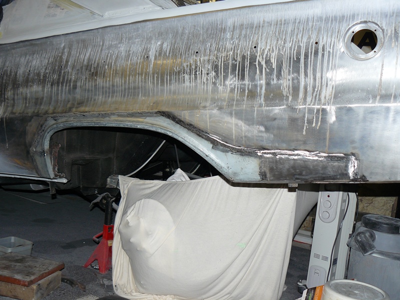

Posts: 8369
Last bit of weld covered up and the edge is all built up nicely now. I may fill it in some more but I don't NEED to put any more on this side, just the high spots to file down then a skim of filler!
