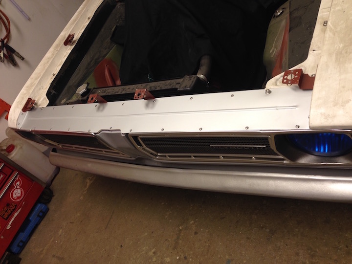

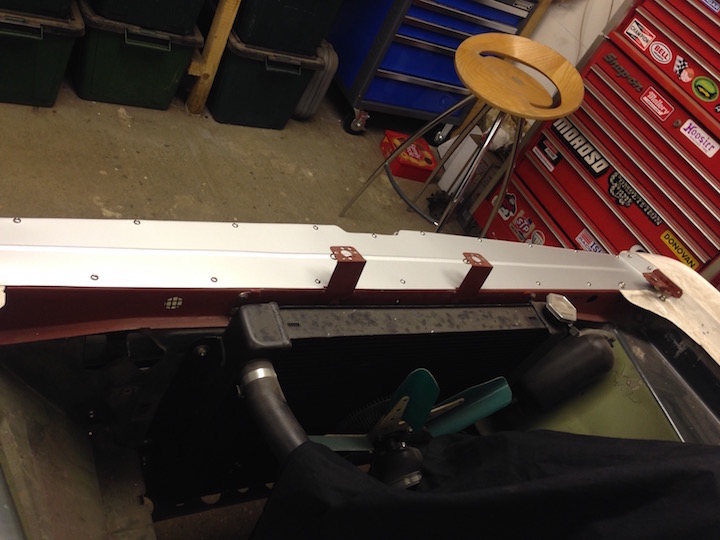

Finished off the front block off panel Today, happy with that. Hoping to be able to back off the Barracuda a bit shortly and get this one done.

Lovely, is it secured with stainless hex heads? Can't quite see in pics... will it stay raw or be painted?
Pimps in the Front
Hoes in the Back
Chumps in the Trunk
68 Dart Post
Posts: 14502
It's pre anodised sheet Dorian, so that's the finish. I used button head fasteners but I wouldn't be useing anything as heavy as stainless now would I? ;)

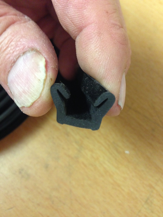

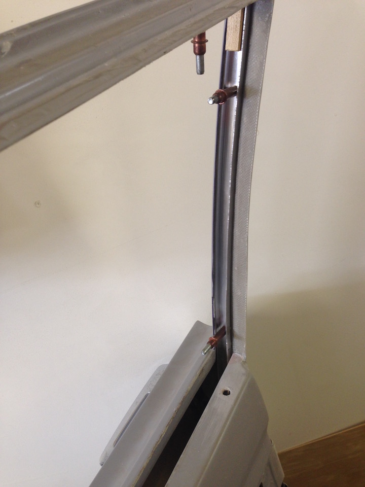

Windows. Been putting this off for ages while I figured out how to do it and what parts to use.
Windows need to open as I can't do with fixed Lexan in a street driven car. I started off by looking for window channel rubber that would fit an available size of aluminium channel.

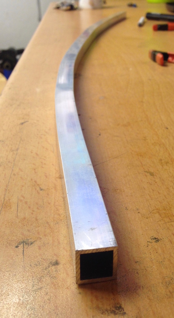

I quickly found out U section channel just collapses when you try to bend it to the necessary profile. Box doesn't so I used that and then cut it to a U section afterwards.

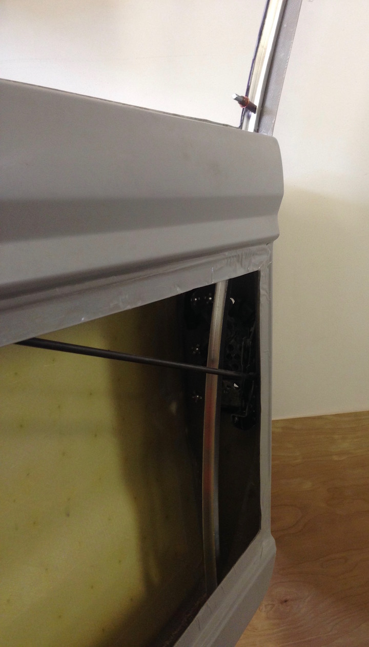

Posts: 14502
I used some square dowel that is a tight fit to keep the corners lined up until its bonded in place. So far so good..
Posts: 1678
Are they going be wind up/down windows? Curious as regulators have some weight :)
Posts: 14502
Not wind up, I'll use a strap to pull them up.
Posts: 1678
Blue wrote:Not wind up, I'll use a strap to pull them up.
Good stuff :thumbright: thought you'd not want the weight of the regulator :lol:
