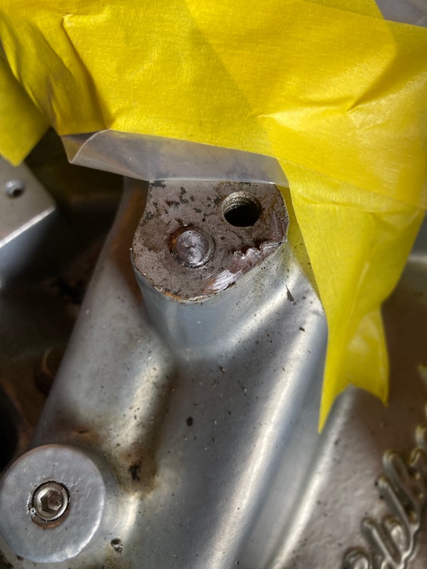

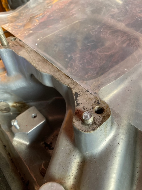

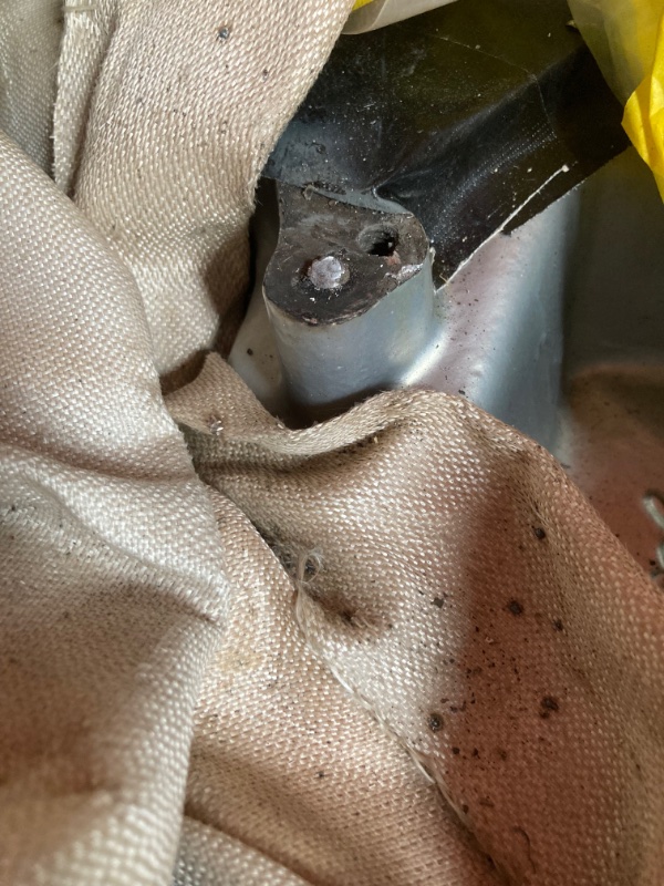

So… that went well!
- IMG_0972.jpeg (147.77 KiB) Viewed 4495 times
- IMG_0974.jpeg (143.26 KiB) Viewed 4495 times
- IMG_0975.jpeg (129.44 KiB) Viewed 4495 times

I’ve got to say I’ve never had that happen, they usually strip the thread out of the intake before that happens. A nut carefully welded over that will get it out.

I think, on closer inspection, where the coaters have masked it off, they’ve not quite got it right and the bottom of the stud has been coated in. Tried everything to get it out, but ended up slipping and taking a nip out of the manifold as well. Been a frustrating morning.
Not sure me, a welder and a fuel system are a clever mix
, so thinking of attempting to drill it out during the week.

Just choose a nut that will drop over the stud, fill the middle in with weld, let it cool/heat soak for a couple of mins, wind it out. Drill it out as a last resort.

It’s shorn off flush, after I managed get a grip on it with a bolt grip, 2nd time lucky I thought, but turned out worse.

Can still be done, you just have to build up a bit of weld before you drop the nut on. The trouble with drilling it out is unless you can get the broken bit out, you'll be lucky to re tap it square.

Blue wrote: Sat Jun 01, 24 5:10 pm Can still be done, you just have to build up a bit of weld before you drop the nut on. The trouble with drilling it out is unless you can get the broken bit out, you'll be lucky to re tap it square.
Cheers Blue, I’ll give it a go before I drill out.
Sod’s Law that a simple carb swap should turn into an epic again.

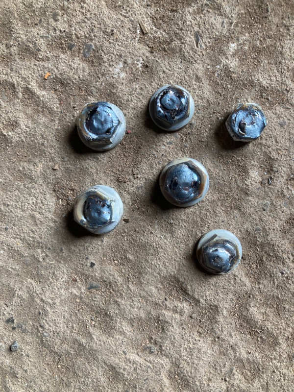

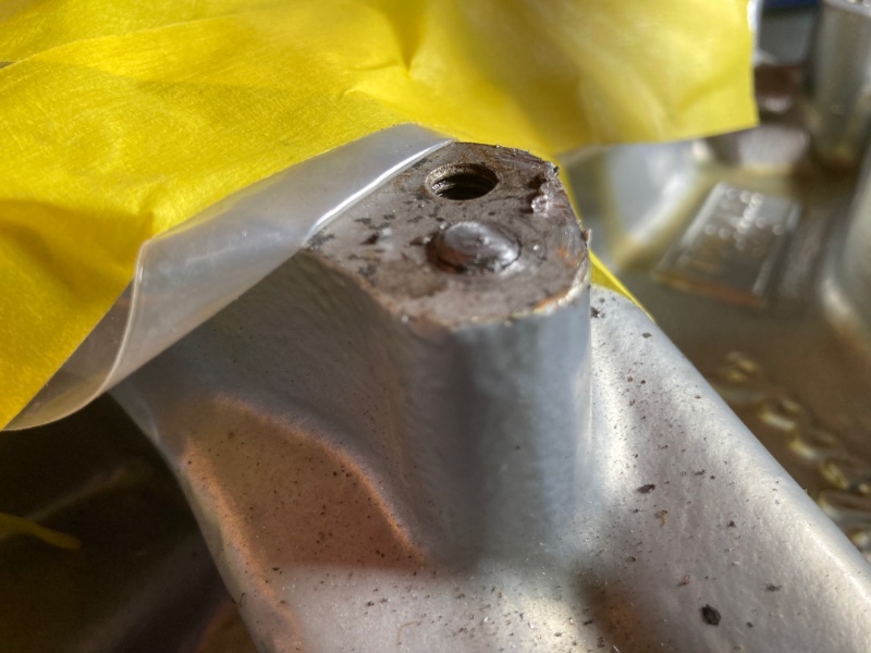

Yeah, that’s not coming out…
- IMG_0990.jpeg (324 KiB) Viewed 4295 times
- IMG_0989.jpeg (218.99 KiB) Viewed 4295 times

Yup! And an hour of an actual welders time, who was kind enough to come and try and help.
Not even the tiniest bit of movement, just kept tearing the nuts off.
Easy-outs next, then.

That’s a pain, never known that method not to work, the heat alone is enough to free stuff off.

Yes, Mr P was of the same opinion, but at least I know it isn’t me!
I’m suspicious at this point that it’s been messed with at some point in its life, something just isn’t right.
I’ve picked up some different style extractors to my usual go-to’s, and will try again tonight.
If that doesn’t work, the manifold will have to come off.
