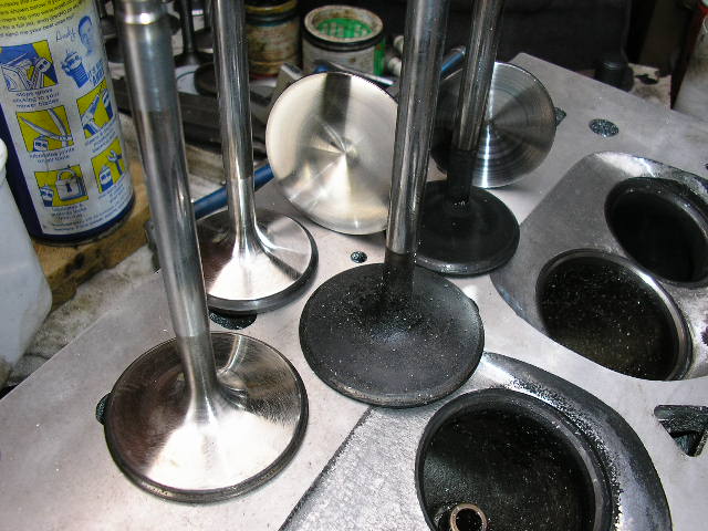

Nice valves TOO!
Clean valves.JPG (75.28 KiB) Viewed 991 times
