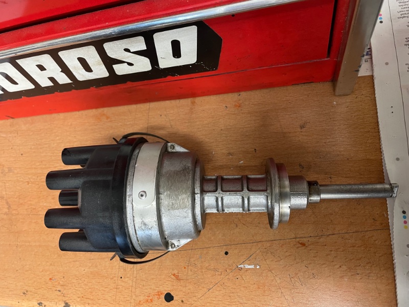

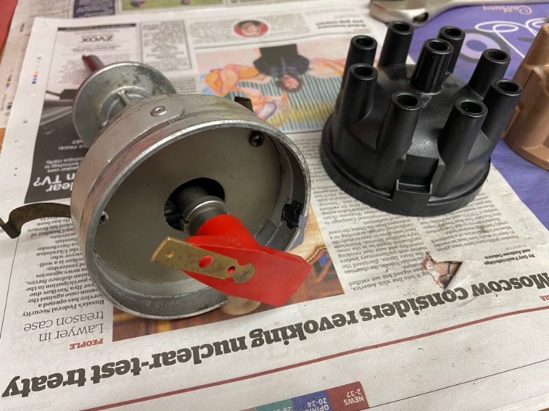

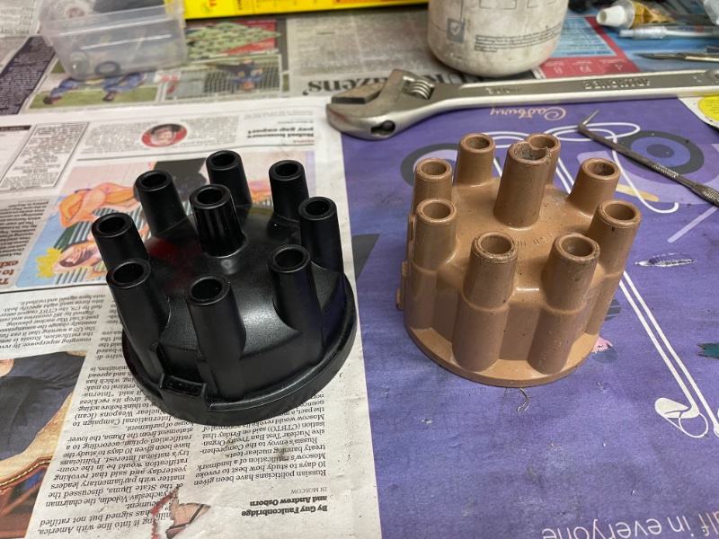

Lately I have mostly been buggering about with distributors. For maximum accuracy I am converting to crank trigger ignition, this means the only job the distributor has to do is get the spark to the plugs, advance mechanism, vacuum pot, trigger wheel, reluctor etc are all surplus to requirements. I bought a used Dizzy to gut, it turned out to be a Lucas built unit for Australian Valiants. It’s much the same as US built units but a bit better quality and uses the same cap and rotor as a Rover V8. This cap has a wider lead spacing which isn’t a bad thing.

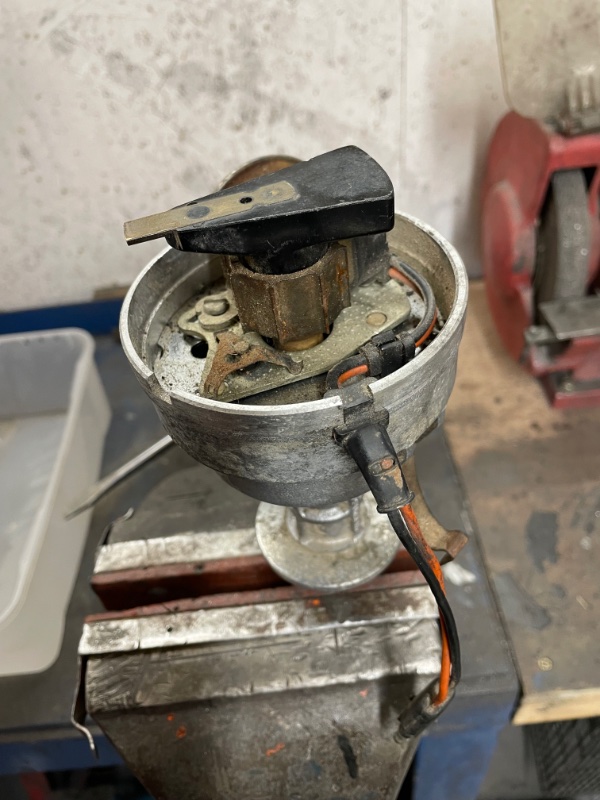

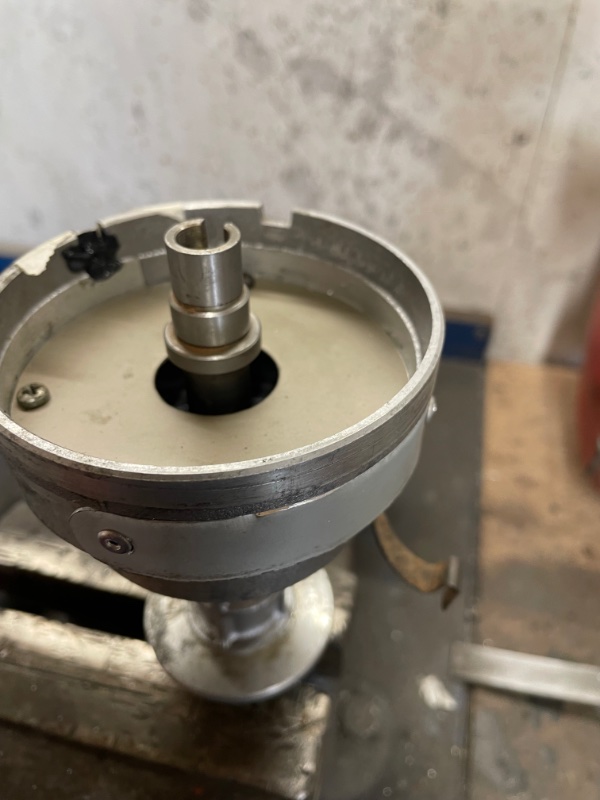

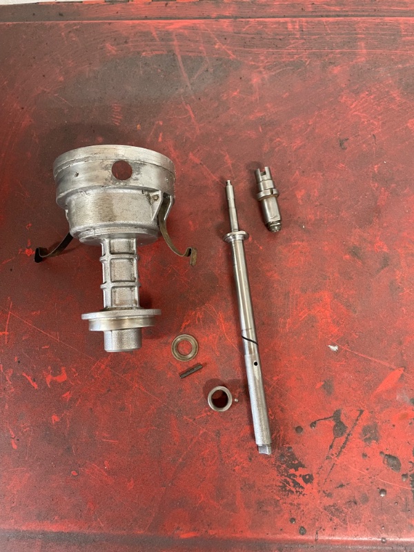

Stripping out everything you don’t need leaves you with this. Just needs the top of the shaft slipping on to the lower and welding solid. Add a sheet metal baffle to keep oil from the bearings out of the cap, cover the vacuum pot hole and that’s it. Waiting for the Crank trigger to arrive and then I can finish the job.

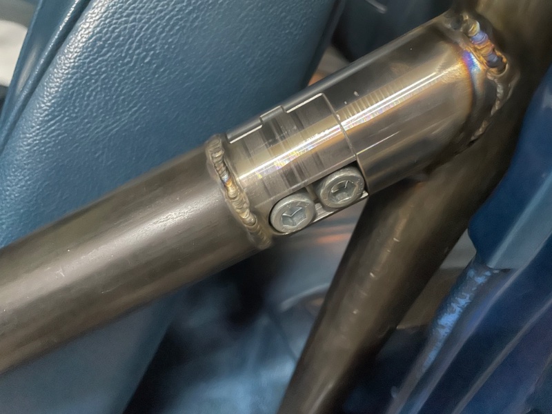

After a year of running wheels up low elevens with little more than a lap belt for safety common sense has prevailed. Dropped the car off at Andy Robinsons Today to get a roll bar made and fitted, legal to 10.00 that will do me.

That cooling mod is really interesting, not seen that before. :read2:
Have you found a colour match for your distributor cap yet?

Re: Blue's Barracuda
Probably sort it when I’m in the paint shop next week Stu .

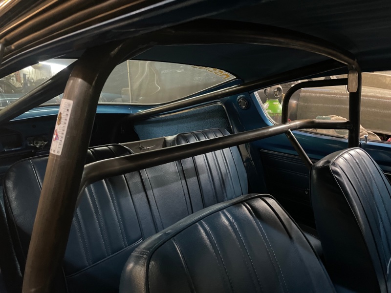

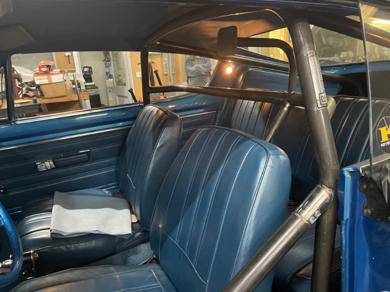

Posts: 14602
Just picked the car up today, very nice job! Door bar is removable for street use. Painting it is going to be a challenge though…

Post by SAV@RPM »
Looking good Blue, I did see your car at Andy’s when I dropped a diff off. Quality workmanship.

Post by Dave Napier »
10.0 cage not 8.50 ?

Posts: 14602
Yes 10.00, won’t be going faster than that.
Blue wrote: Thu Nov 23, 23 8:52 pm Yes 10.00, won’t be going faster than that.
Looks good, should still be able to get folk in the back too !
A while ago I was looking to upgrade the cage in the Challenger to chrome moly, it was expensive back then and I don't think it's got any cheaper since :shock: . £5k+ to save maybe 100lb 8-[ Though to be fair, the cage goes from the front to back and is well above spec in wall thickness. The next car will be a lot lighter though :D
