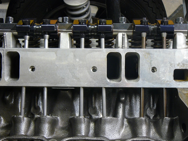

I've bolted the heads on gently using the old gaskets and fitted the rockers.
I have 3 different lengths of pushrod, I've fitted a pair of each to try.
Once I set the lash I need to check how many threads are showing on the adjusters and where the rollers sit on the valve stems.
The roller moves back and forth across the stem tip as the valve opens and closes. If it travels an equal distance each way from the centre line, it's right.
Testing pushrod length.jpg (208.95 KiB) Viewed 1526 times

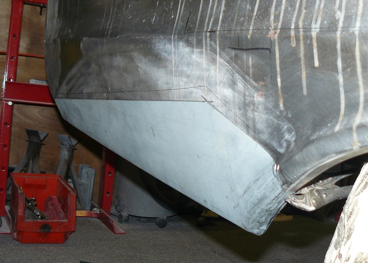

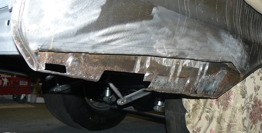

The motor is on hold til I get some cash so it's back to bodywork!

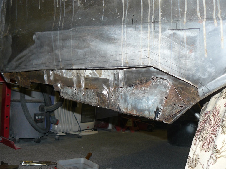

The last repair is on the passenger side lower rear 1/4.
I've cut and tweaked the repair panel, that's virtually ready to go ( I had the same problem with the wheel arch lip as the driver side so tightened up the corners).
This time I've retained the shape so I'm happy to repair the inner 'trunk extension' before I weld the outer into place. I'm doing this in patches to make it easier to retain my lines.
Offside lower quarter. Cutting rust out..jpg (188.4 KiB) Viewed 1822 times
Offside lower quarter. Cutting rust from inner..jpg (190.4 KiB) Viewed 1822 times
Offside lower quarter. Repair patch ready.jpg (168.59 KiB) Viewed 1822 times

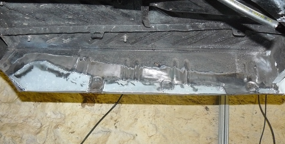

Posts: 8369
Feeling smug- I did some good patch-making and welding today. Apart from rust-killing the remaining original metal the trunk extension is finished.
I now have ONE piece of metal left to weld on :D
Rear quarter. Inner patching done.jpg (243.71 KiB) Viewed 1773 times
Rear quarter. Inner patched.jpg (203.14 KiB) Viewed 1773 times

Hole and patch now trimmed and tweaked.
I'm taking a lot more care with this side to get the edges to line up perfectly so I'm not bridging any gaps with weld. That was a mistake on the driver side which led to a lot more filler! There's no more than 1mm gap right along the mid-panel seam.
Patch edge is joggled, trunk extension flange is punched for 'spot welds' and the whole lot is plastered in zinc.
Hopefully get the welder to it tomorrow :thumbright:

Posts: 8369

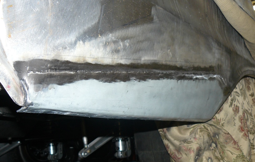

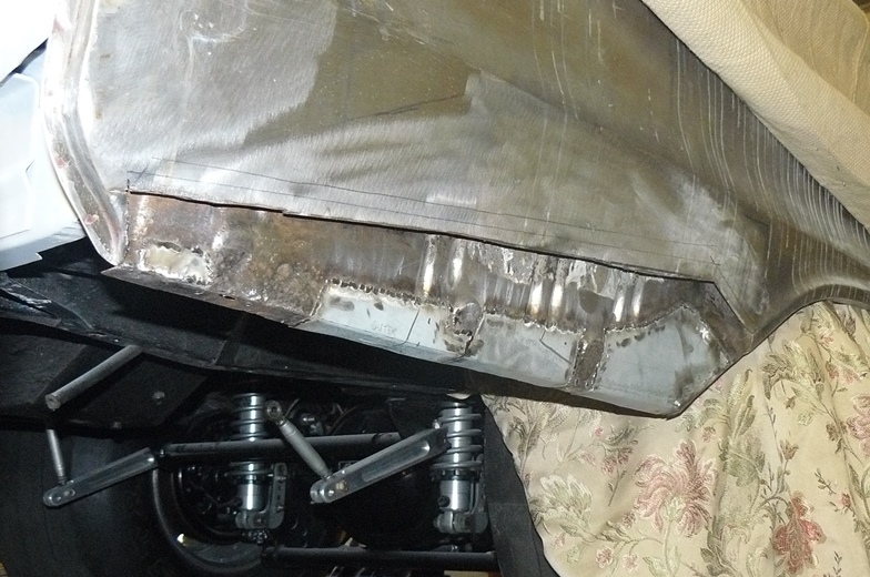

NO.
MORE.
WELDING.
:D
Rear quarter. Welding finished.jpg (170.43 KiB) Viewed 1702 times
Rear quarter. Finished welding.jpg (169.77 KiB) Viewed 1702 times

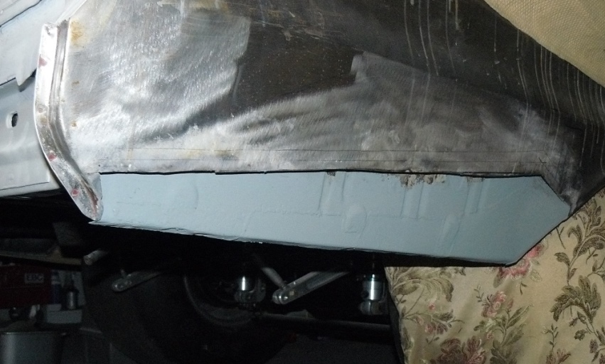

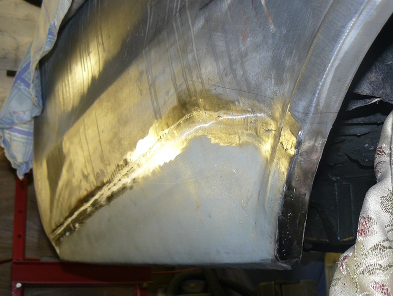

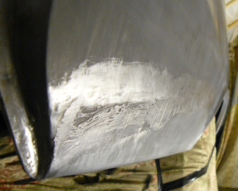

Posts: 8369

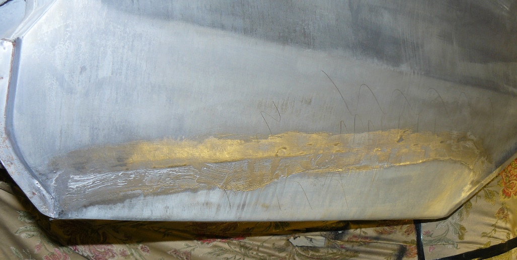

I have this panel stripped clean now, and the seam is leaded and filed.
If my mountain walk is rained off today (which seems VERY likely!) I've hit it with the POR15 now too.
Rear quarter. POR 15 done.jpg (218.11 KiB) Viewed 1657 times
Rear quarter. Lead filed.jpg (161.96 KiB) Viewed 1657 times
Rear quarter. Leaded.jpg (239.07 KiB) Viewed 1657 times

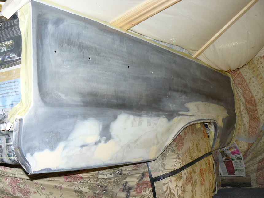

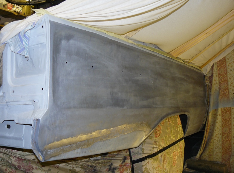

Posts: 8369
Filling this side has been slow and miserable :?
Dunno why, just lost my mojo or summat.
Anyway, it finally came good this evening and is now ready for primer...
Wing ready for primer.JPG (240.93 KiB) Viewed 1645 times
