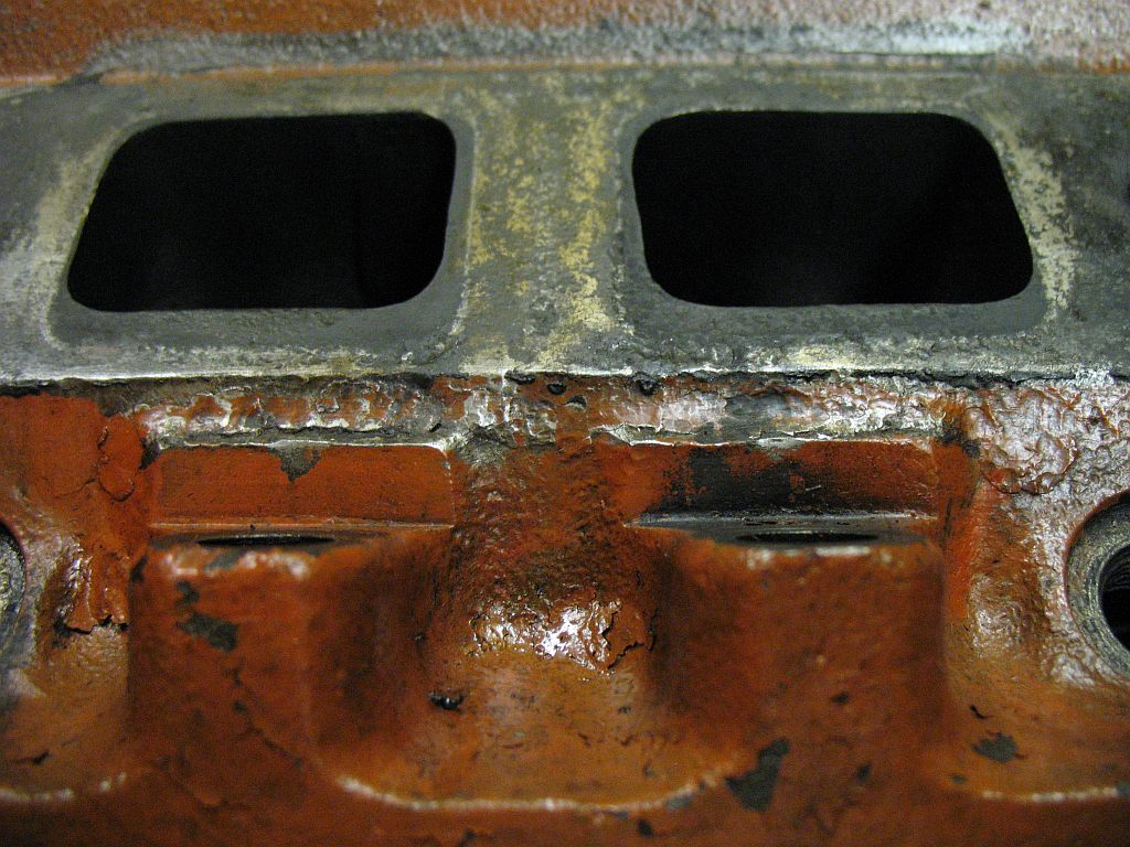

This is my repaired head. See the weld just under the gasket surface for the two center ports?
There is no sign of a crack on the suspect head. Nothing at all. But still water escapes somewhere under the exhaust ports there.

might be worth coating all that repaired area with some kind of epoxy resin dave at least it will rule that part out and much easier with the head off as you well know :thumbright:

Just to be clear. the head photographed above is not the problem head. That one is fine.
The problem head looks MUCH nicer than that. There really is nothing to see and the surface is good, clean and smooth unlike that one.

then there is some porosity inside most likely, perhaps it can be sealed?

Look at these Babies!
All B/B heads go there under the centre exhaust ports! :?
Thats what they do!!!
A build up of heat and stress, turns the iron into mush metal.
