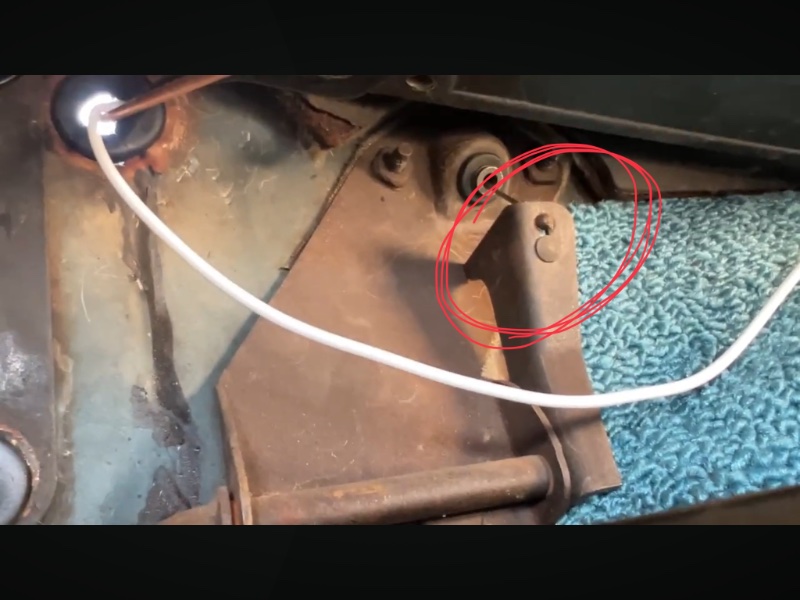

Thanks Mike, but the carb end isn’t the issue, it’s the pedal end.

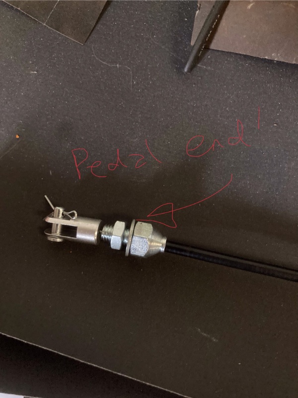

No, the type of fitting at the pedal currently is the same sort of set up as the below :
The cable end I posted is the universal end that is on the cable, supposed to fit on the pedal end.
The carb end is fine, retained ball, but is fixed, so can’t be removed and fitted to my existing cable.

All you can do then is chop the end off and use one of the bolt on bits from the other cable to retain it in the pedal.

I reversed mine around the other way so the nipple end was captured in the pedal

sublimemike wrote: Wed Jul 03, 24 7:58 pm I reversed mine around the other way so the nipple end was captured in the pedal
Ah, can’t do that as the other end is fixed, non removeable end, so it would have to be cut.

Well, a combination of brains between Mr P and Blue, the solution is found and Cinderella SHALL go to the ball! \:D/
Ended up drilling the existing fitting straight through and using a bolt and nuts to clamp to the carb arm.
