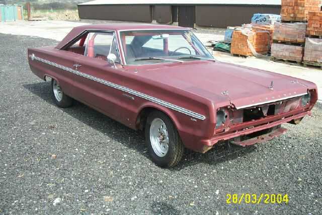

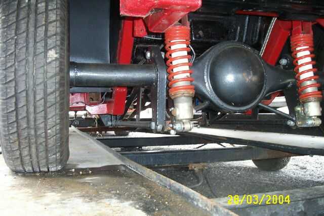

Well i've had it a couple or 3 years now, i guess i should share some pics :oops:
Some of you will know that Andy Neal bought the car in NY State where it was fitted with a Hemi/ Lenco setup. Before completion, Andy took the lot out to stick in another car and the car was sold to Hugh and shipped over here. He kept it for a while but changed his plans and sold it to me in April '04.

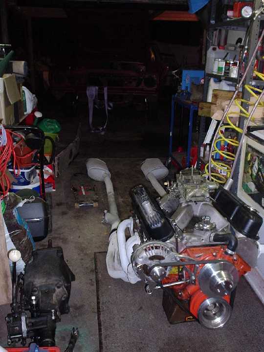

I started looking around for a motor and got the very sweet 360 out of Pete Wiseman's Sox Barracuda.
Around this time i got in touch with Andy to get some more info on the car and he sold me a 727 auto.
Since then i've stripped the trim & interior and cleaned up what little rust there is and bothered Andy for a helluva lot more help with choosing & sourcing parts in the States.

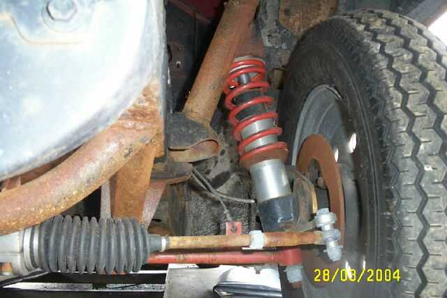

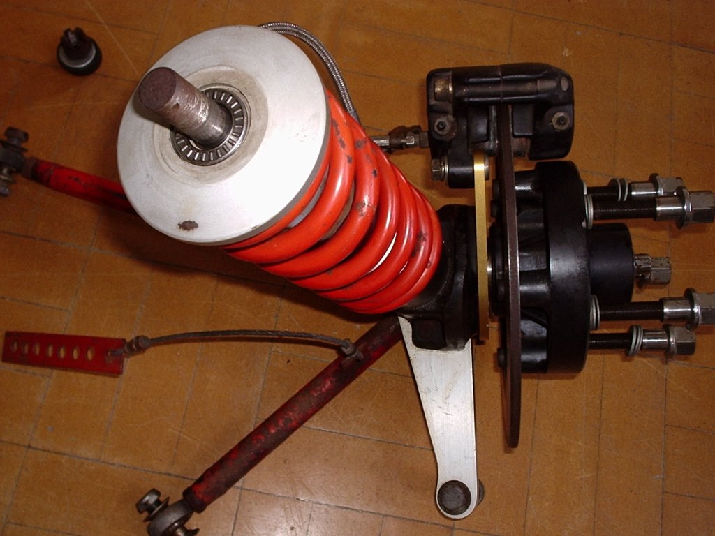

These are the race front struts. So far i've stripped and cleaned em up....plan is to retain the structure, Trev has offered to remake the arms, i have to come up with a new way of mounting the shock-top to the frame as the present flimsy bearing won't stand road use.
I also have chunkier discs & calipers on the way.

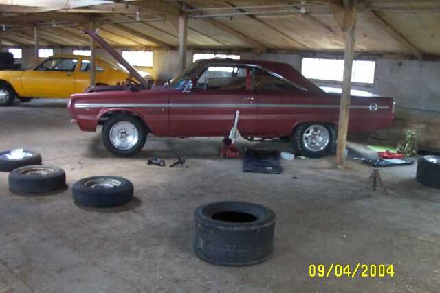

The bodywork is superb, there's lots of scratches & chips in the paint though which have allowed surface rust to start so i been at it wiv me Dremmel and sanding discs, followed by rust killer & etch primer.
My car port roof leaked and water got under the seam sealer in the gutters, had to carefully grind that out too.
It'll be a while before it gets painted so hopefully this should keep it at bay til then.
The worst bits are the rear arches which have been previously filled and the floor which is pretty thin in places. I've a couple of front pans on the way to sort that out, that'll be 1st job in the spring!
