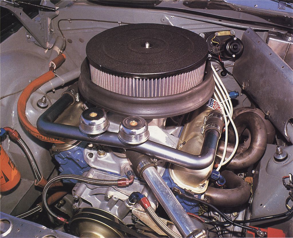

Gurney's AAR Cuda engine. They were built by Keith Black.
It looks nothing like the engine bay on the street versions does it? :D
Nice headers. 8-)
And looking at those shock towers I suspect the front suspension has had a bit of work too. :lol:
