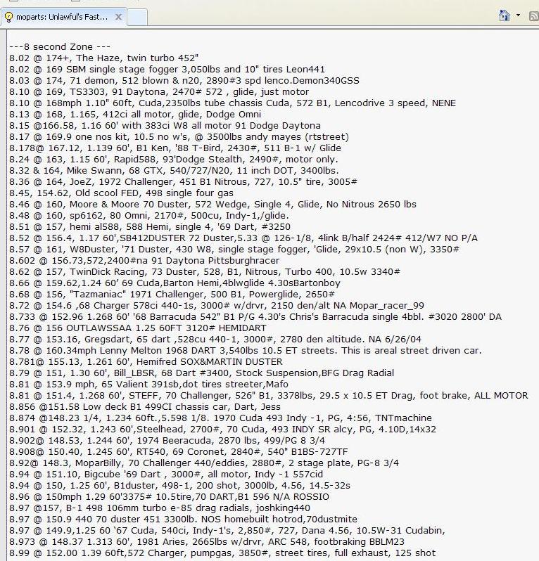

8 second smallblock
I know there are a few in USA now
But will we ever see one here ??
- 8 sec.JPG (182.65 KiB) Viewed 1376 times
