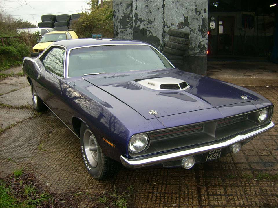

It's in Cheshunt, it's got a Shaker...
Here it is when we got it, lets just say it photographs well...

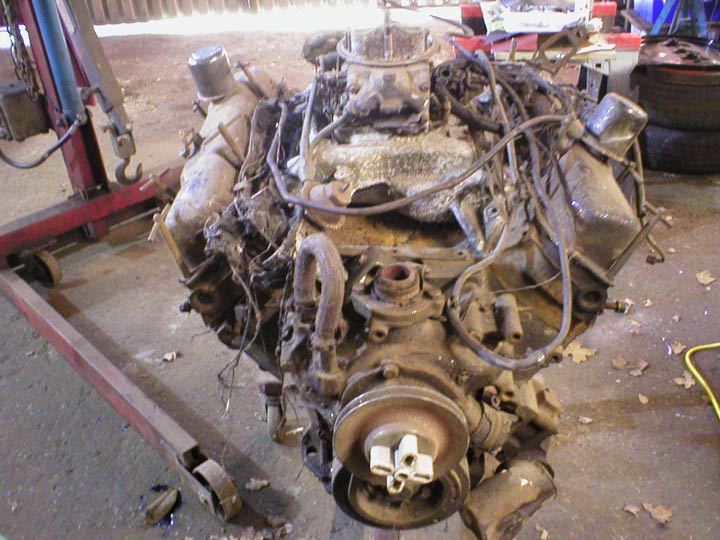

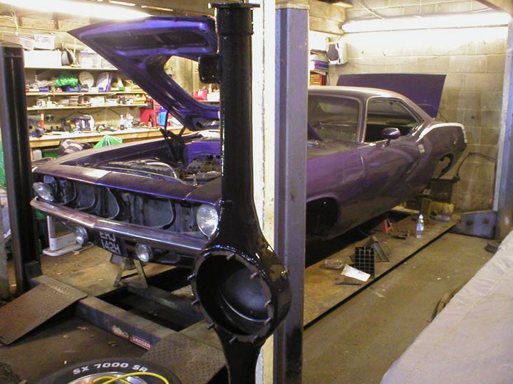

It now looks like this, interior out, rear suspension out, motor and trans coming out this week.
Partially siezed and been on fire, nothing a quick slosh of hammerite with a 4'' brush won't sort out.

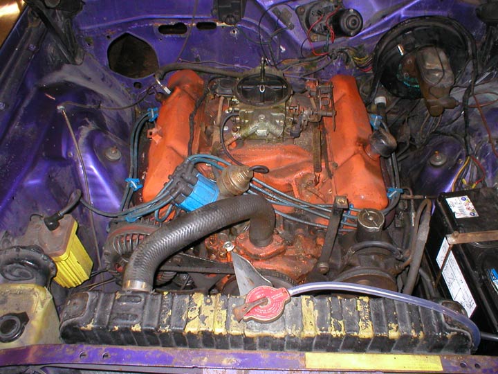

Needs a little pizazz underhood so we bought this...

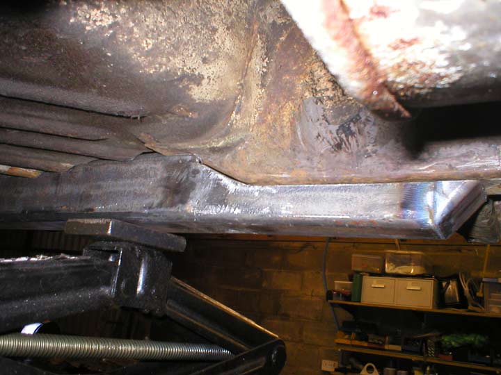

Bit of work going on underneath, will be de scuzzed and shutzed in sections as we go.
Adding torque boxes
Adding torque boxes
Making chassis ties
Making chassis ties

Looks like a different motor to the one in the other pic in the engine bay :?

Blue whats wrong with the present engine...?I guess your gonna say size but what did it have in it.

Present engine is a 383, now sold, going to build a decent 440 for it. The leaking land rover heater that was bodged into it along with the burnt out wiring went in the bin, I don't do heaters let alone air con....

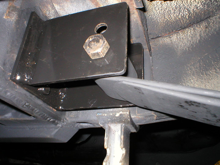

Posts: 14529
Still making slow progress but not much worth showing :roll: I've made new 2" longer front mounts for the superstock springs that also inboard them 1", the rear hanger is also inboarded the same amount. This allows a B body axle case ( just under 2" narrower than an E body) to bolt straight in. This should allow enough space for a 10X15 rim with 3 3/4" backspace to fit. I'll be using period wheels and that is the usual backspace they come with, hence the mod.
