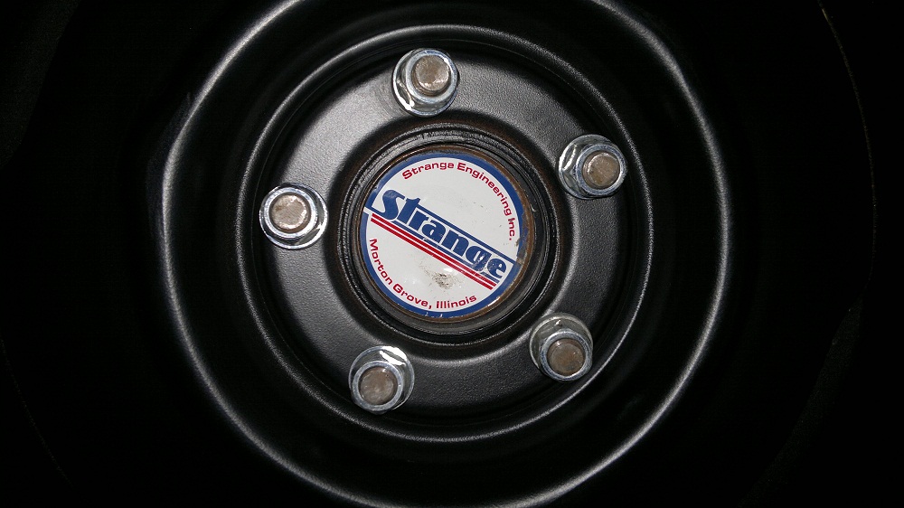

Well I popped down the garage today to give the Coronet a once over before Krispy Kremes on Sunday, and had a look at the rear wheels and it appears that I have bent all 10 rear studs :shock: :oops: which is very annoying to say the least. These are Strange 1/2 studs, the trouble seems to be the plain steels, as the nuts are 60* taper to suit the wheel also I have a 10mm spacer, So any ideas how to sort this apart from driving carefully :roll: maybe taking half shaft's out drill and tapping to 5/8" studs and drill the wheels and spacers out, really don't want to go down that road.

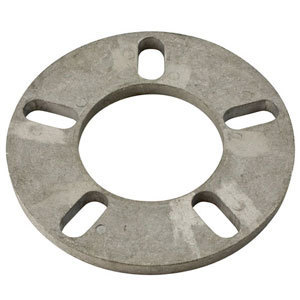

Here's a picture of the same kind of spacer, and a picture of the wheel, So Trev what type of spacer do I need, and can you make it?

GTXJim wrote:Here's a picture of the same kind of spacer,
There is your problem. Nothing for the wheel to center on.

I have run low 10's using that type of spacer - it isn't the spacer causing the issue in my opinion - there is something more fundamental going on.........is the back of the wheel not flat like a Weld or something? There must be an incompatibility issue somewhere...
Pete wrote:I have run low 10's using that type of spacer - it isn't the spacer causing the issue in my opinion - there is something more fundamental going on.........is the back of the wheel not flat like a Weld or something? There must be an incompatibility issue somewhere...
i dont disagree pete, the way the wheel is made will be a contribuating factor but that spacer is naughty
Posts: 22137
Yep, I agree - a spacer is not the way to go but it is a cheap get out of jail card in the short term, especially on the street. I would not by choice run them with slicks as I think it puts more load on the studs.

GTXJim wrote:Well these tyres grip like slicks, and the car weighs about 3500lbs, and I have been launching it pretty hard :D this is why I was thinking of thicker studs, I just can't get my head around a spacer that'll change things :?
picture the wheel getting forced in to all sorts of shapes because its centre is no held rigid, if thats how it is the wheel needs to slip over a spigot,

A goo quality wheel spacer will have a wheel locator in the centre like the link below.

ANTON wrote:A goo quality wheel spacer will have a wheel locator in the centre like the link below.
http://cgi.ebay.co.uk/WHEEL-SPACERS-5x1 ... c0ff287e9f
Exactly. :thumbright:
