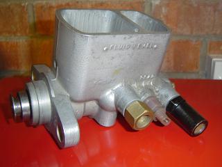

Anyone know if there is any way to speedily obtain a seal kit for the 1972 Chyrsler Valiant Charger Master Brake Cylinder.
I have the standard fitment cast iron unit similar to the below and the seals are shot on the plunger.
Thanks

Issues ref master cylinder
Obtained a master cylinder seal kit from Oz to rebuild the cylinder, all well until I hit problems with all 3 Tube seats as they were welded stuck.
Have removed them using an easy out but the threads are knackered on all 3 seats and two of the 3 valve springs have disintegrated.
Has anyone any tube seats and valve pressure springs to rebuild the cylinder or even a refurbed unit so I can get the car back on the road ?
Cheers guys,
David.
Cheers guys,
David.

I have two master cylinders one is a from my VH (black ms) 4 bolt pattern with a servo which needs the valve seats replacing.
The second master cylinder complete with a servo I assume is a VJ type 2 bolt pattern BPR (silver ms) but this has a missing lid/cover unfortunately.
Hence either I replace the valve seats on the VH or find a cover and refurb the VJ.
Dave999 what is the condition of the VJ ? I take it would need a rebuild ?
Any other options open out there as I'm desparate to get the car on the road and MOT'd as I'm nearly there with only the interior to then sort !
David

Both servo's for the VH and VJ are fine.
The issue with the back VH cylinder is the valve seats are knackered and need replacement. I've sent an email to pentastar parts in Oz to see if I can obtain replacments but still await a response.
The VH cylinder I do believe is Girling hence hoped you guys might be able to advise on replacment seats from another type of UK/European type car with Girling fitment as the Cylinder looks okay and I've fitted a new seal kit.
In the meantime thought I'd ask you guys because I want the car on the road fairly soon. I'm missing the best of the weather and the NATS coming up !
David
David
