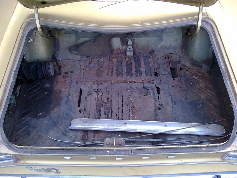

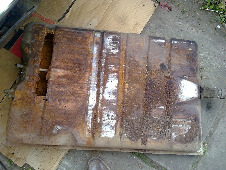

I took out the gas tank to cut out the rot in the trunk 1st, only to find the tank had a massive hole in the top. What a great start! :pale:
(I hope it helped you out Del?)

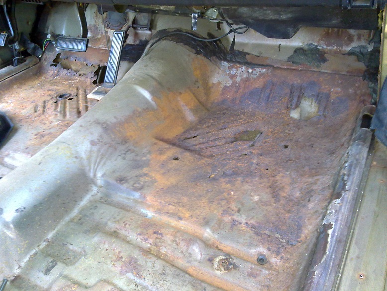

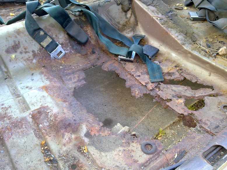

Anyway, after cutting out the rot in the trunk, I had a mad 5 minutes with the grinder and cut out the rest of the tin worm in the floors inside the car.
.... so much for doing it bit by bit #-o
4 floor rot rear.jpg (241.29 KiB) Viewed 2205 times
3 floor rot front.jpg (187.18 KiB) Viewed 2205 times
1 trunk rot.jpg (190.18 KiB) Viewed 2205 times

I had a new rear floor section floating about in my spares corner that I never used in the Charger which fitted nicely on the drivers side,
but all the other panels I had to make up.
I borrowed a welder off my mate Darren (owns the Sox & Martin Superbird) and started renewing the panels.
The weather has played it's part in delaying work on a few weekends :thunder:
but progress has been steady. :)
All the floors and trunk are now welded in, primed and painted. :thumbright:

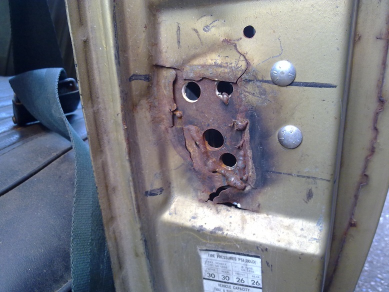

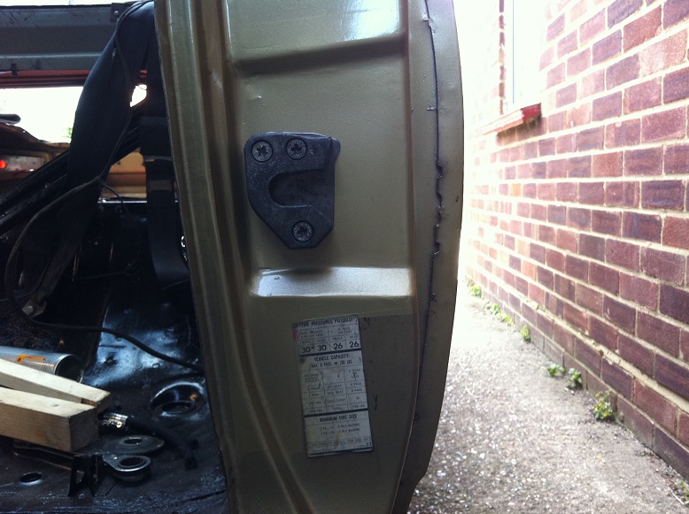

When I bought the car, 1 thing not mentioned was the total cock up someone had made around the drivers door catch area. #-o
All the photos of the car I had showed the drivers door being ajar.
Naturally I just thought that he hadn't closed it properly after exiting the vehicle to take the photos.
Hopefully this'll be the only horror story I'll come across. [-o<
This is what greeted me when it came over! :shock:

Post by Jules »

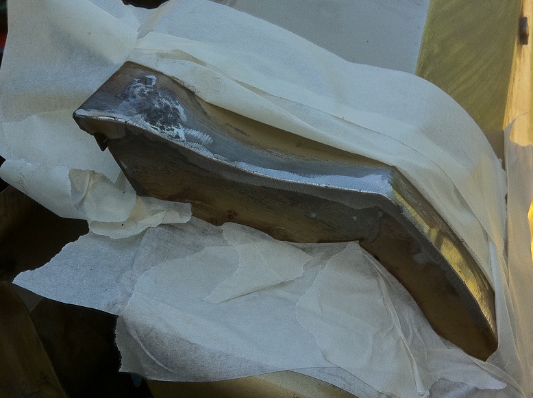

The catch, rear plate and screws were either on the floor in the rear of the car (luckily they never fell out), or in the rear quarter area itself behind the (missing) door panel.
No sign of the shim though, so 1 was ebayed in from the states. :ebay:

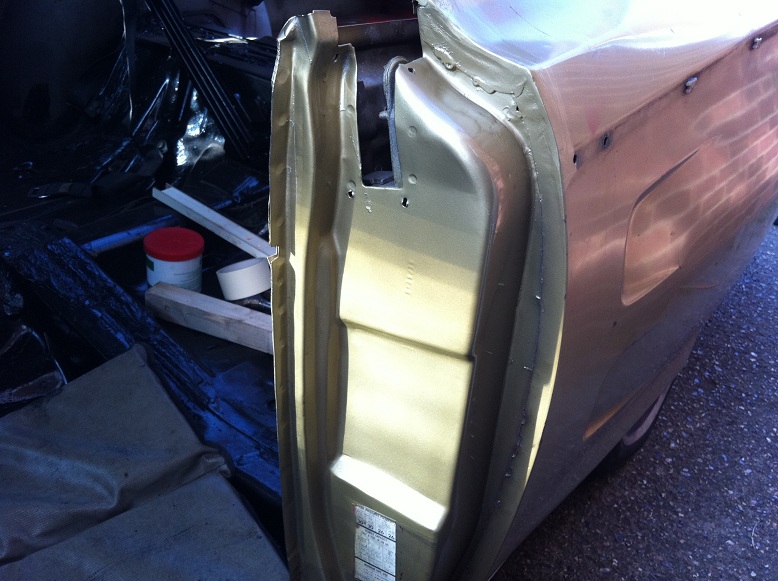

The b post also had a split at the top. :roll:
A few hours playing with the welder and grinder soon sorted that out. ;)
The door catch has also been fixed and now works like it should! At least the door stays closed now. :lol:
A big thankyou to my mate Roo for the extra pair of hands with that job! (cheers fella :thumbright: )
3 b post repaired.JPG (157.67 KiB) Viewed 2166 times

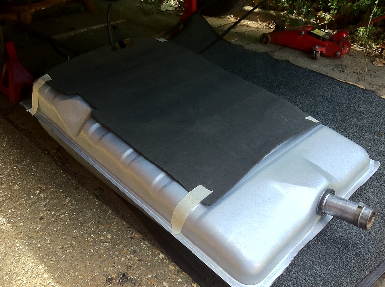

Saturday I fitted the new gas tank and sender. :thumbright:

Sunday I filled a few gas cans up from the local dispensary, filled the new tank up and fired the old girl up \:D/
Fingers toes and everything else were crossed at this point praying that the tank didn't leak the liquid gold I just poured into it [-o<
Thankfully my prayers were answered for once. All dry as a bone up under there. Sender and pipes all in as tight as a ducks derriere.
