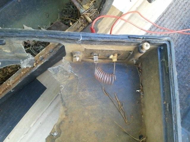

Thought you may like the electrical engineering that was done to the old heater box of yours.
Don't think I fancy melting/burning my car this way!
- 2011-08-25 16 48 22small.jpg (56.38 KiB) Viewed 477 times
think thats the thermister.
resistance increases as the air gets hotter its supposed to either speed up or slow down the fan whichever is appropriate.
you get a thermocouple attached to a switch and one of the sliders in an aircon box
but only one of these in a heater.
sorry its got holes in it....
what a pain
what a pain
