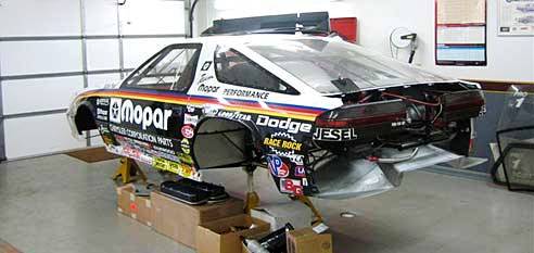

I am in the process of building a Darrell Alderman Pro Stocker replica that will look like this ( mine is a 91 his was a 92 but keep it to yourselves ;) )
darrell alderman 1992.jpg (22.65 KiB) Viewed 481 times
