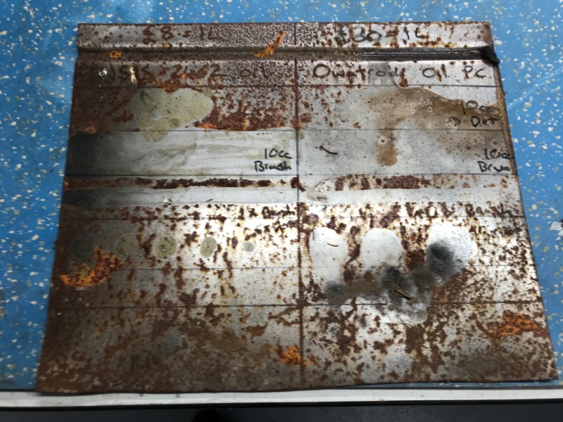

Well car is clean a few spots but mainly all good. i will have to spend tonight de greasing the car as the diesel has made and oil film over everything.
So can of worms and all that theses are the rear frame legs just before the rear panel.
I want to fix it properly as the car is a keeper but do not what to put new rails on it. what would you do
- Dave-R
- Posts: 24752
- Joined: Sun Apr 18, 04 11:23 pm
- Location: Dave Robson lives in Geordieland
- Contact:
Personally I would cut out all the rusty bits but keep as much original metal as possible. Then neatly weld in new metal and shape/cut holes as close as possible to the original look. Done neatly, with good penetration on the welds and grinding, the repair should only need a very light skim with filler to look invisible.
