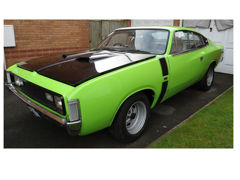

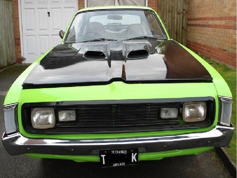

Well it's been a while coming, the first time I have driven the beastie and to my knowledge the first time it's been driven in over 8yrs.
Since being taken off the road she's been treated to a replacement engine/box, most of the braking system replaced, ball joints, gaitors and electrical faults sorted and a multitude of things refit and she was ready to go.
Drove well, with the only sticking point ATF dripping from under the tranny tunnel when I returned home, will check that out later.
Loads of little issues to sort for MOT, then cosmetics for the interior, but shes now a runner....hurrah ! Oh and get rid of those bloody wheels as I have some slot mags to polish, tyre up and fit.

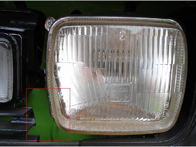

Piece of advice I can't help but think I'm missing some metal trim work from around both headlights (area in red) service manual doesn't show any trim but looks odd to me ? If I'm missing something can anyone help ?
What do you thing guys, another one brought back from the dead......

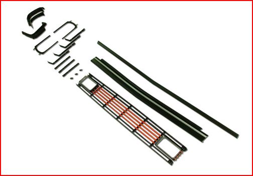

These pics any help with your grille?
http://www.pentastarparts.com.au/sunsho ... ail&p=4199
inner C pieces are missing
pressed steel inner headlamp bezel
they are a trim piece that goes round the light and bolt to the grill
queensland valaint spares had some a while back
this is their quote for parts i was interested in
the grill AUD200
the top of the grill surround AUD160
the ends of the grill surround Cast ally C Bits AUD40/ea
the bottom of the grill surround AUD100 (secondhand)
and the inner C shaped headlamp surrounds AUD40/ea
must be in restorable condition so they can be 770/RTed.
also drivers side drving light mount the metal bit AUD150/ea (secondhand)
have plastic and front with lense but metal bit is mushed
the grill AUD200

no its all there
just painted black
if you look at steves picture and go NW to SE
items 2 and 3
items 1 and 2 cast ally grill ends you have
items 2 and 3 pressed steel c bits you don't have
items 455656....... supports and spacers are all part of the central grill
the rest grill top trim extruded ally section
grill botton extruded ally section
grill
and drving light bezels
which are hard to see on your picture but must be there otherwsie the lenses fall out
i.e all present and correct apart from pressed steels items 2 and 3
just painted black
items 2 and 3
grill
Oh yeah
looks like you are missing the alloy corners under the indicators as well
although hard to see
they go behind the bumper and are usually painted body colour
they fill the space that would be taken up if the wings were used with a full wrap round bumper off a chrylser BY Chrylser
only VH
VJ indicators had itegral trim pieces
only VH

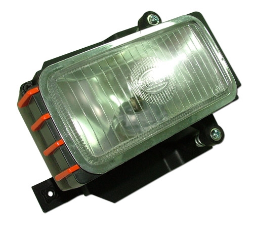

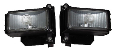

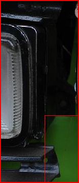

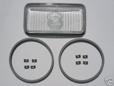

It's the ends of the driving light bezels that I can not see in this pic. makes me think they are not there...
Are the driving lights or the bezels 'handed'? Is it possible that they are on the wrong sides and upside down. Making the finned end of the bezel inboard instead of outboard?
