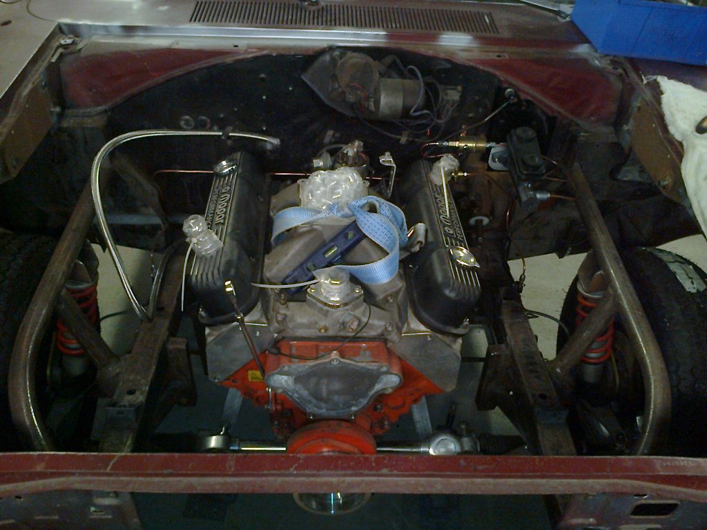

I'm about to make a plate for my hot-360-totin' Belve.
Anyone have one they photo for me?
Is a mid-plate really necessary? (trans mount is poly)
Any advice on dimensions and frame mounting would be great please, mancini, chassis engineering, etc sell 'em from 3/16 to 3/8 thick! :help:
motor in place.jpg (141.62 KiB) Viewed 1809 times
Posts: 22171
Mid plate not necessary.
However on high horsepower units it pays to fit bars to prevent forward and aft travel as the motor WILL flex a motor plat, no matter how thick the material. The Sox had them from the trans cross member to the gearbox to save space but many people put them from the frame rails to the motor lugs.
Posts: 8369
Nice one, ta :thumbright:

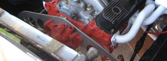

Also Alli for your front one and mild steel for your mid plate. This is the Moroso front plate with 2 no M8 bolts each side straight onto chassis rails
Posts: 8369
Is that your plate Jon? Where's the alternator sit :scratch:
Is 3/8" right for the front?
I've realised i'll need to make an equal thickness spacer for the crank pulley so the belt lines up!
I'm really struggling to find pics on t'internet, looks like i'll have to rely on good old-fashined over-engineering :thumbright:
Jon Connolly
Posts: 3116
Post by Jon Connolly »
This is mine Paul ... give me a few weeks and I`ll send you some better pics ( knackered my back )
The water pump pully is the " thickness of the plate " out of line ... this can be sorted by machining the back of the water pump pully and front of water pump pulley flange i.e. if the motor plate is 3/8 then machine 3/16 off each face then put the pulley on with the std bolts and everything lines up
Make sense ???

You'd be amazed what you can achieve with a grinder, a holesaw, a steady hand and lots of patience ;)
