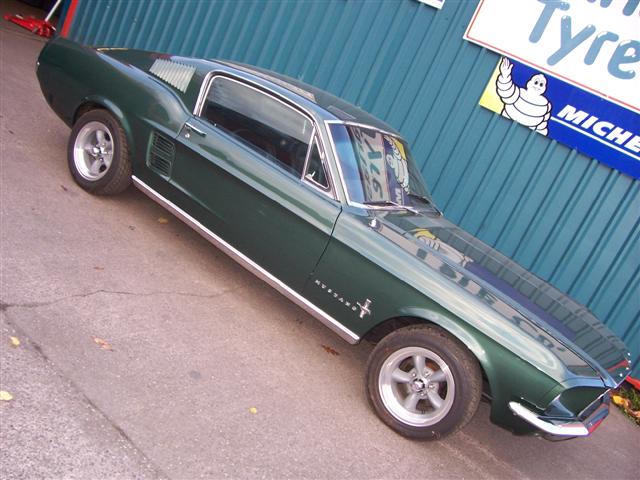

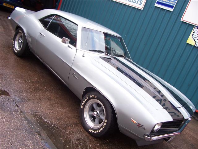

Posts: 5239
wheels Torq Thrust D 8.5” x 15” backspace 3.75” all round, tyres 275/60 x 15 at the back & 245/60 x 15 up front :thumbright:
BUDGIE
Post by BUDGIE »
What is it with TTD's....................:scratch: :lol:
