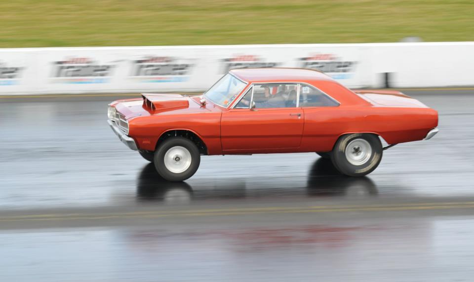

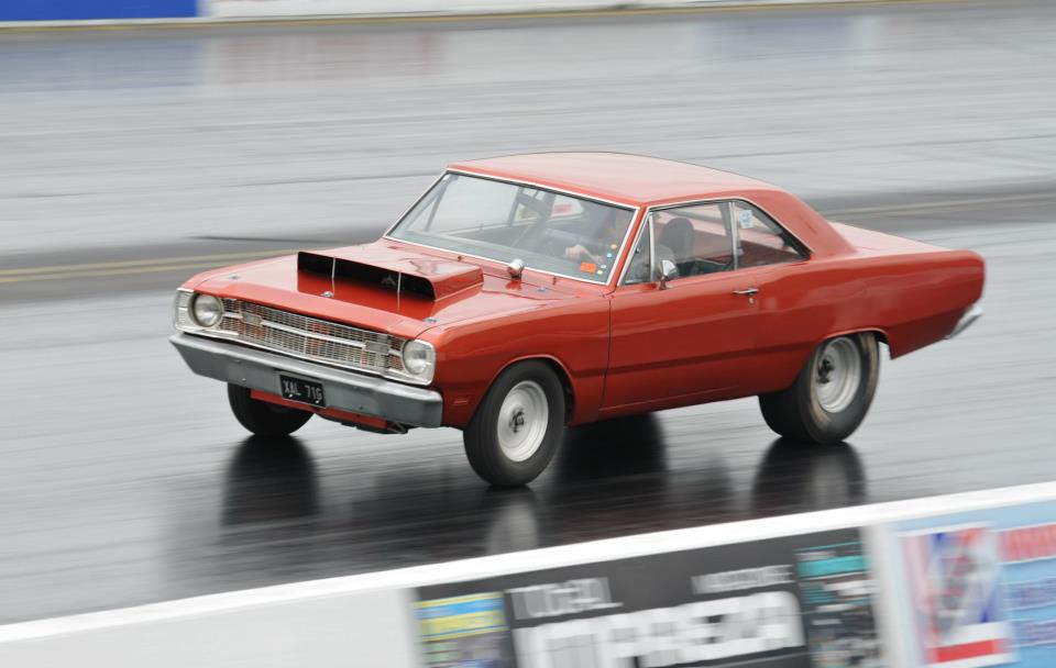

Well, ran a new best 60ft today 1.43 but speed was down on the run, tried a QF dominator but wasn't as crisp on my motor as the 950, tried jetting but still down on mph still managed a 10.40, swapped the 950 back on and ran a 10.37 but picked up nearly 3 mph, then as the track got colder did 2 more runs but both times i had to get off the loud pedal.
All in all, a good day, car ran reasonable and i drove it onto the trailer at the end of the day.
A local guy was there with his early camaro but broke his water pump, so didn't manage a run.
Graham Ellis was pitted opposite me, did 3 runs but blew the tyres off and shut it down on every pass.
My 1.43 got some nice air. :thumbright:
