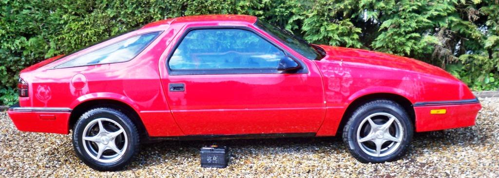

1989 Daytona tube chassis race car

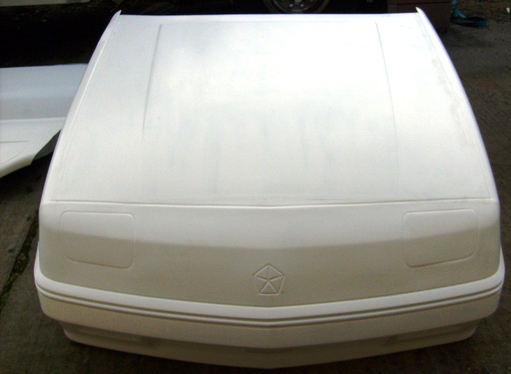

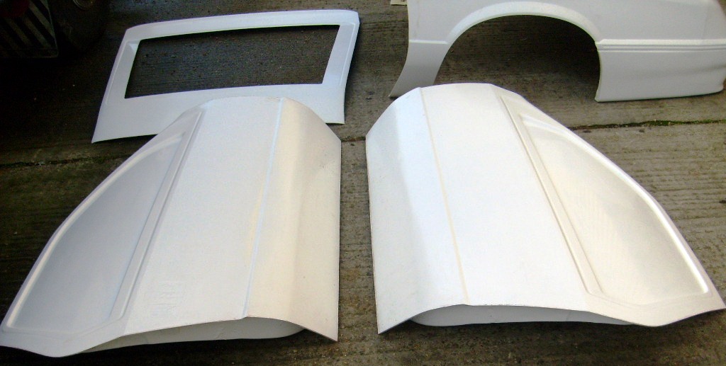

Ex Paul Mander cage tagged to 7.50 with 4 link rear
Steel centre section
DRE fibreglass nose, doors, boot

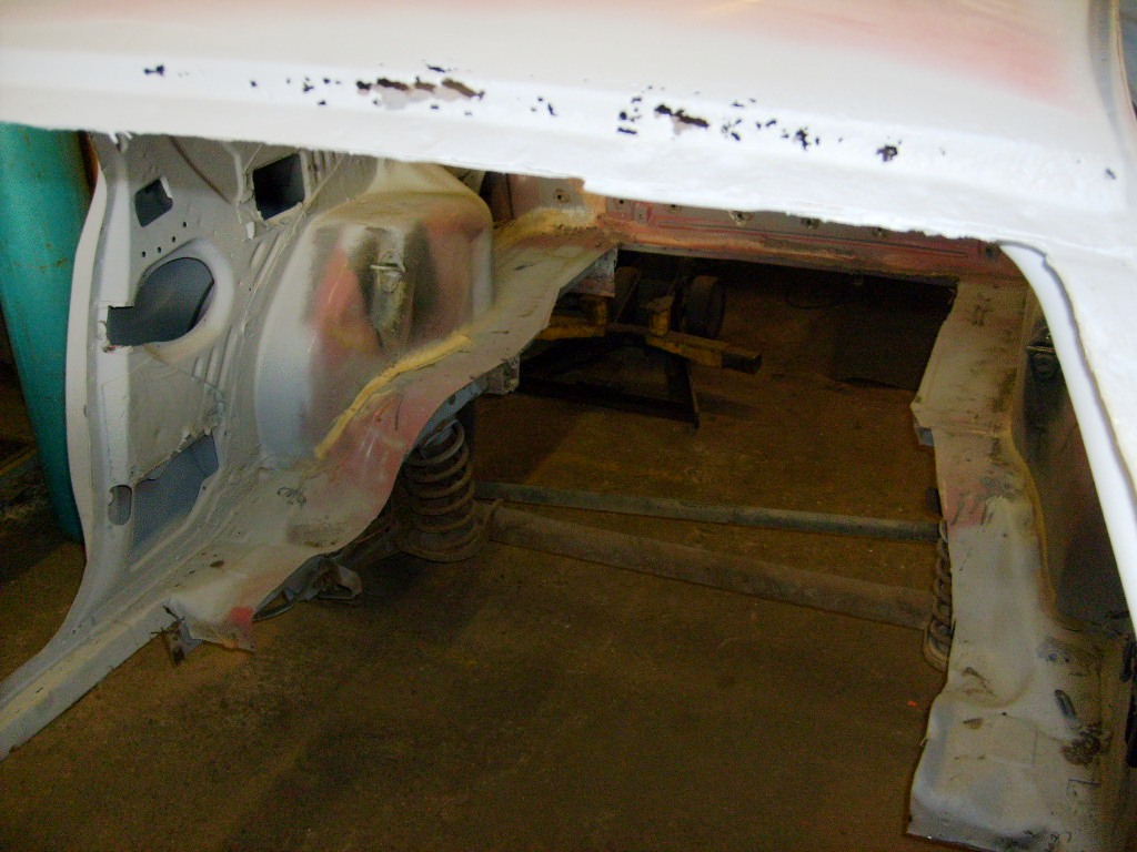

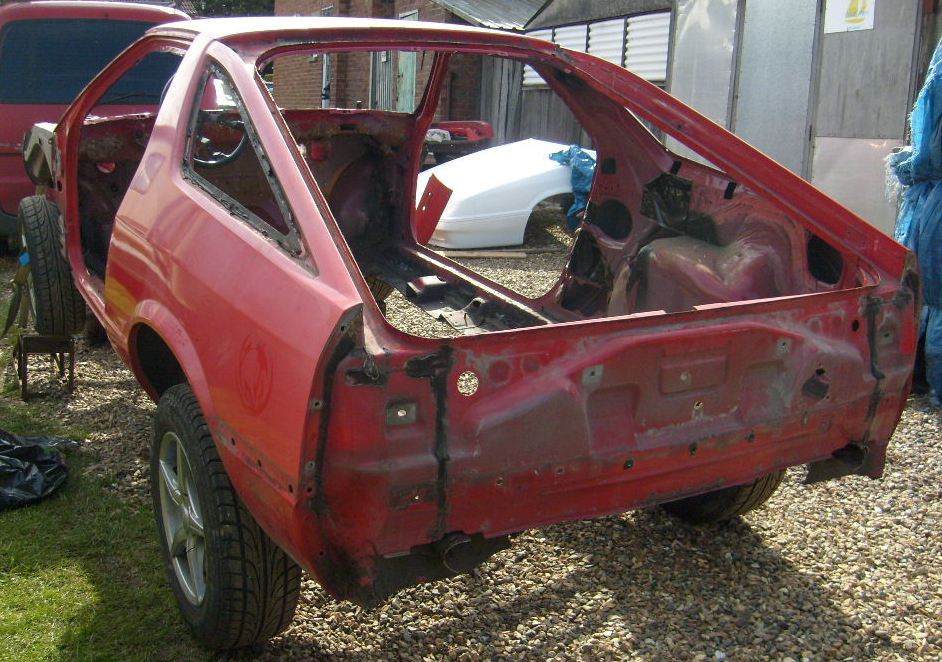

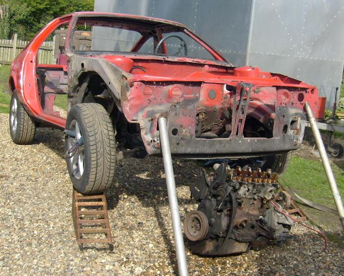

Took yesterday and today off work and had a good go at this
It is now still rolling and steering
Will afix some unistrut left to right bearers to allow transporting
Next stage is to get it blasted and primed ready to plasma cut out the remaining floor sections and bulkhead
There is a nice inner sill / ledge which lends itself to have a couple of pick up points and I am leaving all the double skinning in the passenger compartment roof and walls for pick up points too
Rust isn`t a major issue ... just a few patches around screen and outer sills

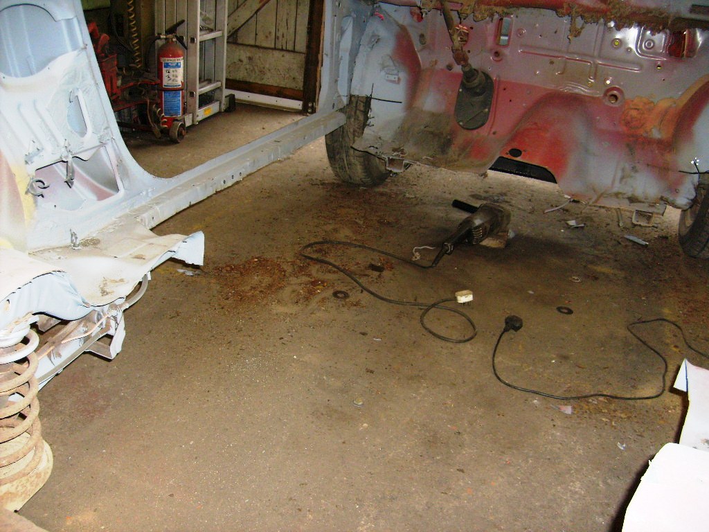

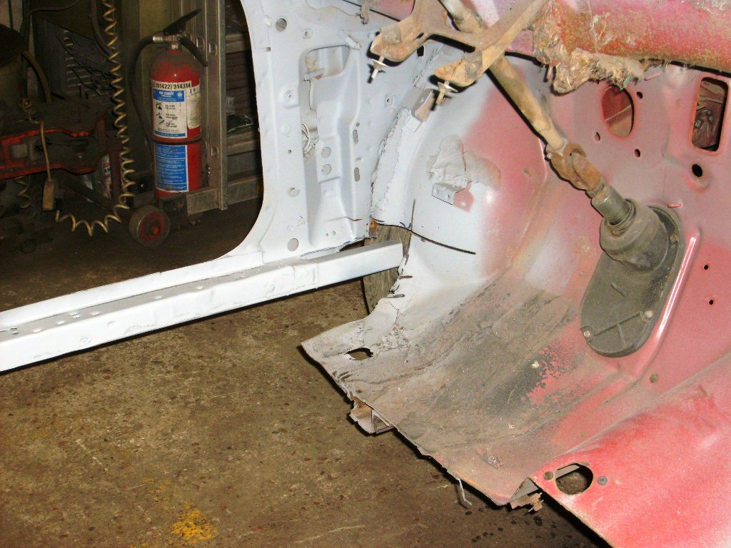

Got the car back from the blasters today and it is a bit rough around the edges ...
All of the rusty bits are being cut out
The inner and outer sills are now cut out and a new 50 x 30 box will be welded in beneath the bottom door shut joint. These will then be secured left to right to each other to stop the body flexing
The front of the car, front sub frame and firewall will be cut out next week before putting on the jig

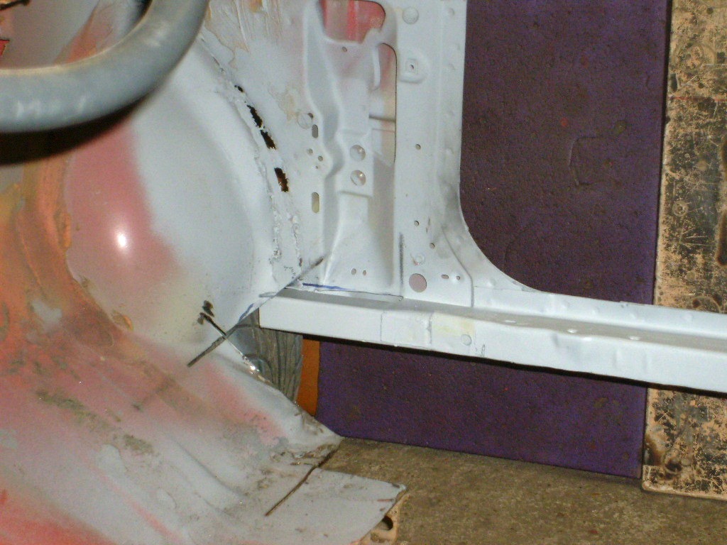

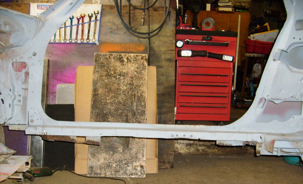

50 x 50 x 1.5 mm box section now mig welded in place full length under each door shut ... this is to give rigidity to the bottom of the car to allow 2 pickup points each side straight into the box section
This will also be a good interface for finishing floor edges and supporting outer sills
Next job is to put " unistrut " spreaders in to prevent any bowing then all the remaining sheet metal can be removed
