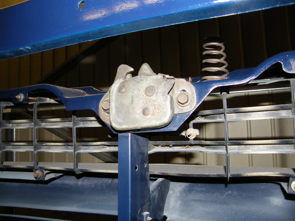

Hi all
We're looking at getting the Satellite's hood latch / catch mechanism plated (clear zinc, or zinc & clear, seems to be the correct finish, looking at various places on t'net) but aren't too sure how well it would work if it gets plated without first dismantling the assembly :-k
Dunno how easy it would be to take it apart and then put back together, but dont want to get it plated 'as a whole' only to find the individual parts dont rotate or pivot properly cos of the plating, or even that the plating all flakes off after the first time the hood gets closed :?
Anyone else had any success getting this assy replated?
Thanks in advance :thumbright:

So if we got a hood latch assy, that has a few moving parts, plated as one item, would the plating stop it from operating properly? Or will the parts still rotate or pivot freely?
Just need to know whether to try & disassemble first...
Ta :)

Here is a first hand answer to your question - it will be fine! I've had door locks and hood/trunk latches plated , it won't flake off and you don't have to disassemble the parts. And it's cheap!
Two caveats:
Firstly the plating will either not get to or only poorly get to parts that are 'hidden'. So on a latch there is usually a part of the metal which slides over another metal part. If one is covered during the palting then it won't get fully plated. I'm not sure there is really anything you can do about this other than disassemble the latch (=not worth the effort and result). As long as it is plated in the position it is usually seen in there won't be a problem. You may find a line across the part when you pull back the latch and look at the bit underneath. It depends on the gap as well. So - if this applies, just make sure you get it plated in the position you want it to look best in. Or talk to your plater, I guess in theory they could plate it twice - once in each position. Regardless, it is really not a big deal.
Secondly if you blast it you will find the plating reflects the blasted surface - i.e. sand or even glass beading will leave a 'matt finish' to the metal, and it will still be there after the plating. So it will not look like the natural metal, if you care about that. If you do, then degrease it and let the platers handle it, they need to prepare it for plating in a bath which will get rid of rust etc anyway.

There you go, I went through my pics and found a before (as delivered to plater but without spring) and after pic.
I would not worry about messing up your original, the worst that can happen is you get it replated. Just be sure of what finish you want and what you will get from the platers. Usually their standard 'clear' or 'silver' zinc is not exactly 'correct' for our cars - too shiny/bright. This did not bother me as I'm not going for 100% 'correct' just something close. If it bothers you then make sure you see what you will get.
Also, again I stress that whatever surface finish you deliver it with is what it will come back with. The plater can get rid of rust but if it has affected the surface finish then the plated part will still show that difference. If you really car about that (on one or two parts I did - e.g. not door latches but a hood latch probably yes) then find a way to get a finish you like. Best tip I have is to glass bead then polish with superfine steel wool to get as close to original finish as you can.
My 2c
PS - the latch is not as shiny as it looks in the pic. And in case anyone points it out or is interested, the correct finish for my latch (71 Chall) is actually 'brown zinc'. IIRC I did actually get this replated in black zinc.

MrNorm wrote:Here is a first hand answer to your question - it will be fine! I've had door locks and hood/trunk latches plated , it won't flake off and you don't have to disassemble the parts. And it's cheap!
Two caveats:
MrNorm wrote:There you go, I went through my pics and found a before (as delivered to plater but without spring) and after pic.
My 2c
