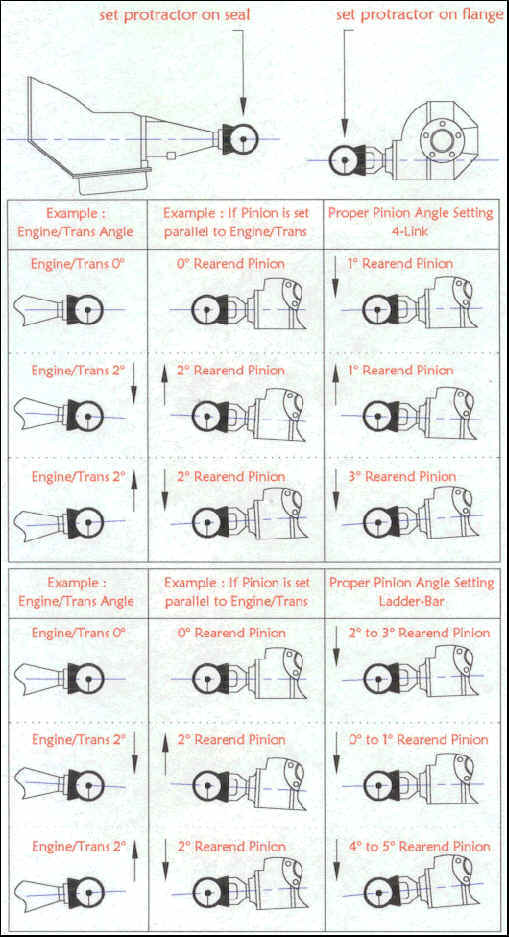

Posts: 8369
This is a handy reference guide, thought it doesn't cover Caltracs
pinon angle plotter.jpg (63.3 KiB) Viewed 1097 times

Post by Mick »
Yes but it does show you the correct way to do it, i weighted the drivers side when i fitted my new perches to simulate the car race ready with driver.
