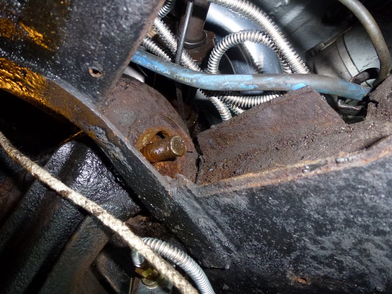

Had a whole day on this today.
Gone really well - whole of one side pretty much off APART from one little bit... as usual, 10% of the job takes 90% of the time.
Spent 2 solid hours on this.
Stupid problem. Cant get the bolt out of the rearmost top a-arm.
It turns (the cam) stiffly. The bush look shot to bits - suspect binding inside or something.
Tried levering it, supporting a-arm, whacking the bolt, levering it. Just Cant shif the bolt. Its the last piece and its driving me nuts.
Front one came out fine. This one though. Grrrr...
Worst case scenario I suppose I will just cut the bolt in half and start over with a new one. Seems daft though.
So. QUick and silly question. Any hot tips ? Any trick-of-the-ttrade type advice before I get medievil with it ? :)

I had to use an oxy/acetylene torch on mine. Burned the rubber out then heated the inner bush until it was glowing red. I don't see any other way to free it if you want to reuse the bolt.

Firstly, it's not a bolt. Not in the usual sense, they are specific and have 1 of the cams welded on and a flat for the other cam.
Gareth and Stu can tell you chapter and verse on this, not sue if their thread is still intact.
The inner part of the UCA bush has rusted onto the cam bolt.
Try the usual - heat, put the nut on an try to hammer it out.
Worst case is to saw BOTH sides of the bush/cam bolt - great in situ.... :roll:
God luck..

The blowtorch was next. Thanks chaps - confirmed my fears.
Extinguisher at the ready :)

As Pete says, bit of heat stick a nut back on then a good whack should start it moving. New adjuster cam bolts are available from moog anyway http://www.rockauto.com/catalog/moreinf ... cc=1078444 it would be best to replace them anyway if you are overhauling the rest. When you put it back together use some copperslip on the new bolts then you won't get the same problem 40 years down the line!!!

That is a PIA for sure I have used a sawzall with a thin flexible blade and managed to cut it out,
but yours doesnt look that bad give it a whack and buy new ones as mentioned ,
and lots of anti sieze and also silicone lube where the rubber slides on the steel shaft

Yep, been through that nightmare. We eventually resorted to a heavy duty recip saw with diamond grit edged blades. It was a bit of a rodeo ride hanging onto the thing in that confined space but it got the job done where all else had failed.

cam bolts prolly bent , thats why its not coming out , read all kind of horror storys just before i done mine , & was prepared for all kinds of grief , but could pull them out by hand :shock:
think i would get a saber saw in there , cut through the shell torch out the rubber , cut the bolt

Brace a Bottle jack in there some how and try to Bananarama! out ??
depending on how bent it is...might get you a start with constant hydraulic pressure on it

Will try to get out there and get some heat on it and find out...
To be honest, I am feeling that cutting the bush and the bolt might be easier - new bolts available, and probably easier/cheaper than some of the pain described on the thread.
Will try and get another go !!

I did have trouble getting the old bushes out of the A arms though, because they were completely shagged, they no longer lined up to come thro the hole in the A arm, carefully cut the bushes so not to damage the A arm, sounds a lot easier doing that on the bench than it is trying to get them bolts out from under the car :roll:

heat it up with oxy kit. Forget a blow torch or lighter

The problems can arise as the bolt is sleeved and the bolt can rust into the sleeve, in which case you can hit it as hard as you like and it won't budge.
