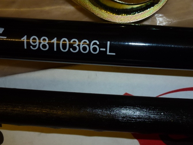

Look at the girth on this !! compared to a heavy duty 779. Mein gott.
I know some of you will be interested, so here is a close up.

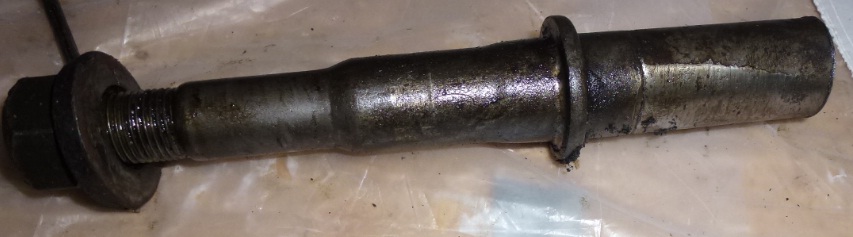

PS - One for all - What is this thing called. I mean I know what it IS, but what is it CALLED ? (its the pivot/spindle for the lower suspension arm). Nearest description I can find is 'bushing and shaft'. You might not want to google that. :) Seems pretty worn - I mean its taken 45 years to get that far, but wondering if... you know... while its out... (sigh)
lower control arm pivot, and yes it needs replacing,,Bananarama! up
You can upgrade with a pivot shaft that is grease able
