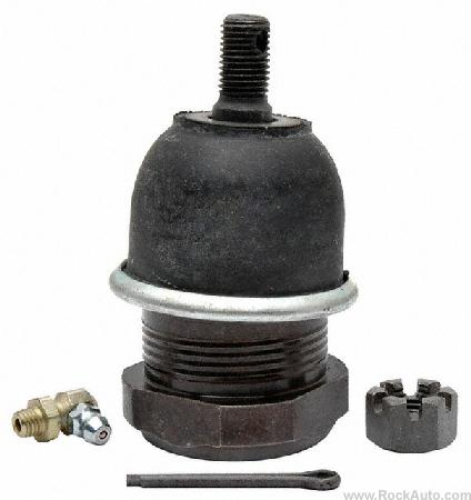

Need 2 upper ball joints for MOT. Is Moog the best to go for and can i get them in UK. Thanks, Gerry

These are on rockauto. Moog or raybestos for 68 dart. Isn't this it?
Posts: 9615
moog yep

in my book worth paying a bit more OEM and OEM seals. metal/plastic rimed seals rather than your normal boots
i got mine of this very bloke when the exchange rate was good so it cost me somthing like 50- 60 quid + 15-20 for postage
was expensive but i was in a NOS mood
Moog is to Mopar like New process is to mopar like saginaw is to GM
OEM factory at least

Dave, does your car use the same upper ball joint as the yank a bodies?
Posts: 9615
Same as far as I can tell. All mopar top ball joints fit all mopar top arms 6? To at least 73 in us a body land
Taper should be the same as that used on early a body because all early Aussie a bodies were made from US parts
All Aussie upper balljoints listed as fitting from 62 to 82 so nothing changed since the ckd kit built r and s series
Lowers have different angle to steering arms to achieve decent Ackerman I think when the steering cross shfaft is being pulled the wrong way by a reversed steering box set up

Dave999 wrote:Same as far as I can tell. All mopar top ball joints fit all mopar top arms 6? To at least 73 in us a body land
Cheers Dave. Ive got them listed on our site at £15.97!!! I did have some. I need to check stock in Aus. Maybe i should get all of them!
Posts: 9615
well if you look at an aussie mopar its mainly 1968 barracuda/dart
so a lot of the range will fit
obviously BJ35 and 36 won't as the lower balljoint lever angle is different for RHD
but the rest, front, back, shocks brake flexis bump stops roll bar bushings etc
all the same
2 rear spring eye sizes
2 types of strut rod bushes
idler probabkly fits
pitman probably not bent the right way
the rest is just mopar A body small balljoint
