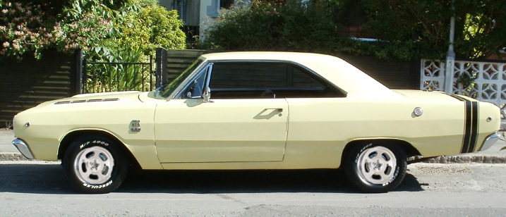

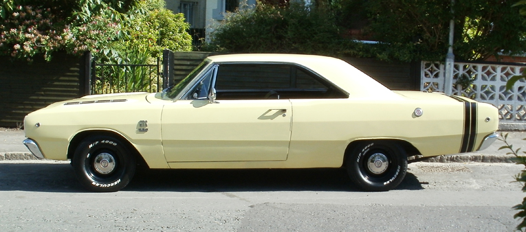

Have steelies on the car, also have dog dishes (not on at the mo, prefer the look). Fancy a set of ansen mags. Small bolt pattern. 15 x 7" 4" backspace, 4" PCD. Would these fit all round or would 6" on front be better? What do you think. Thanks, Gerry

Well it's Ansen slot mags all the way for me Gerry, but I think you'll find 7" rims on the front will rub the chassis leg and clip the front of the wheel arch.

But those dog dish wheels look the stuff!
Proper mean stance. :thumbright:

but summers coming, want to show a bit of leg!

The dog dishes look better I think, and im not a fan of the DD but they look great on yours 8-) :thumbright:

both look good :thumbright: Rallyes look good also :thumbright:
