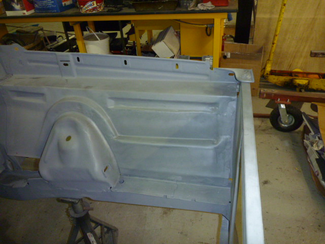

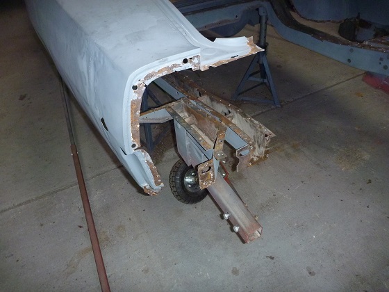

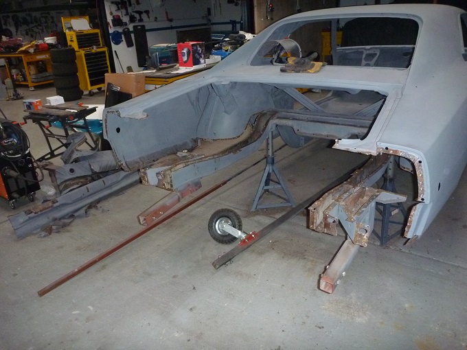

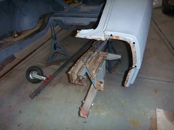

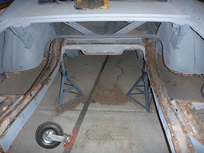

metalwork has now started now I have new panels thanks to RON FENTON,(good bloke) new bootfloor complete rear end, lower rear 1/4,s few other bits on car to do then, prepare,prepare,prepare! will keep u posted

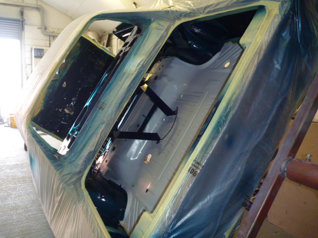

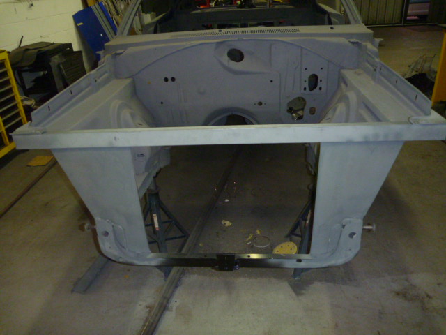

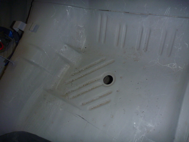

PAINT!
Post by mr m »

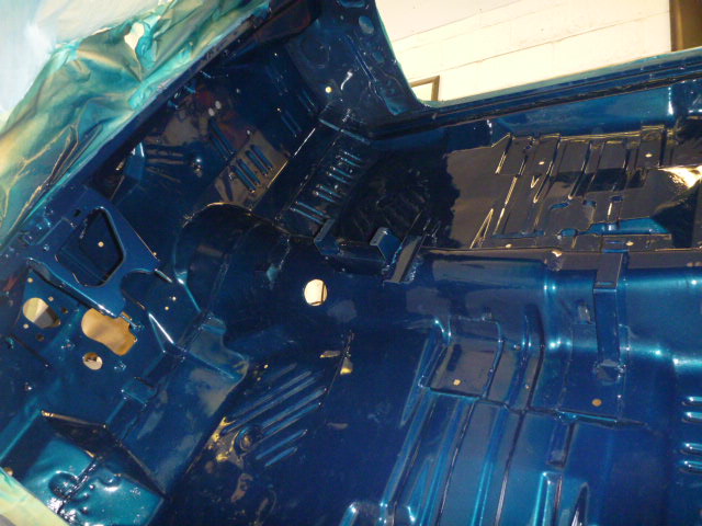

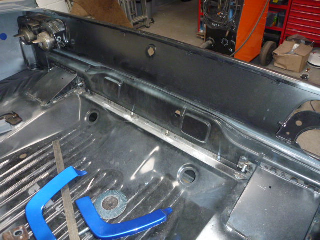

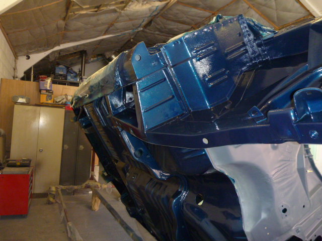

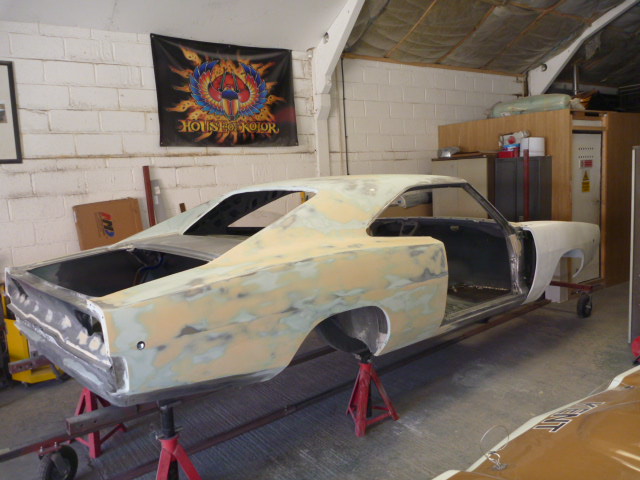

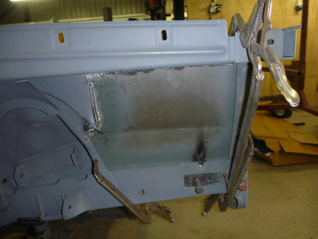

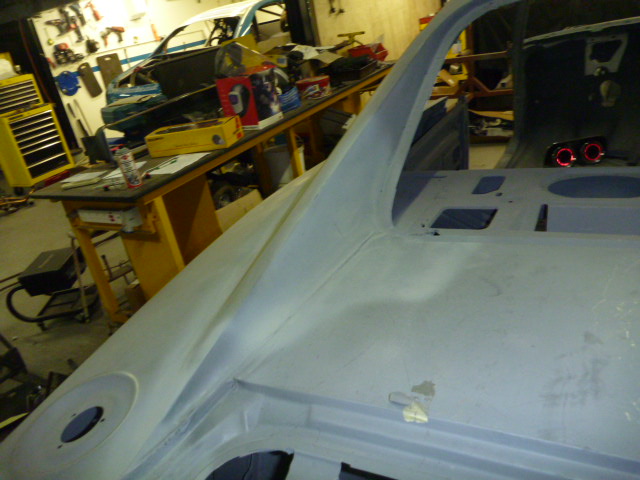

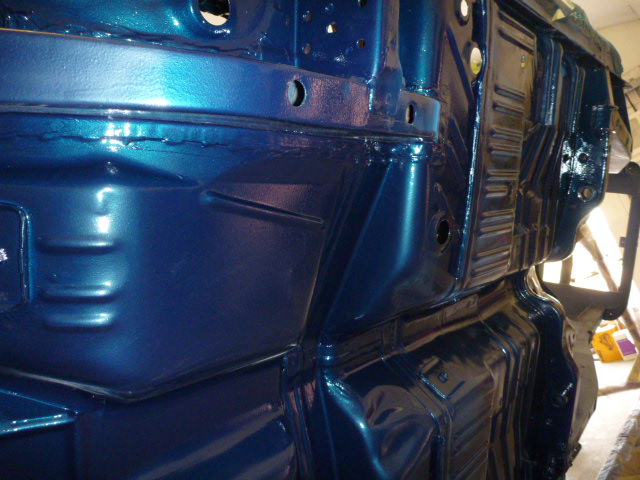

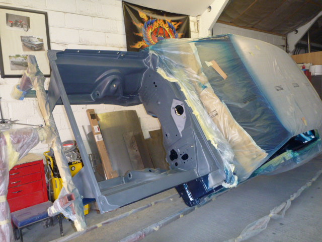

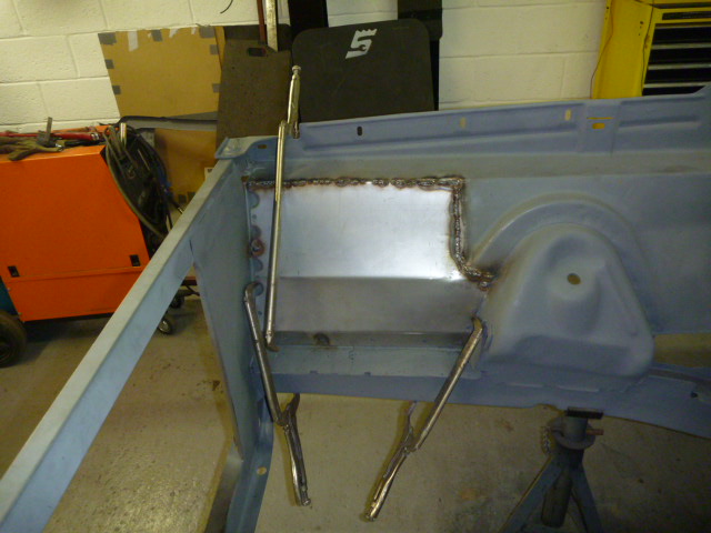

SIGNS OF PROGRESS stitched welded chassis through out subframe connectors smoothed bulkhead flitchs and front panel. modified boot floor so modified tank sits higher into floor

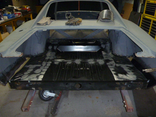

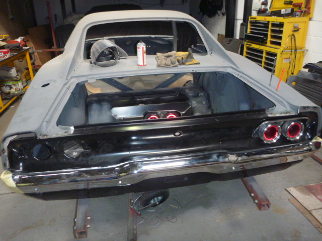

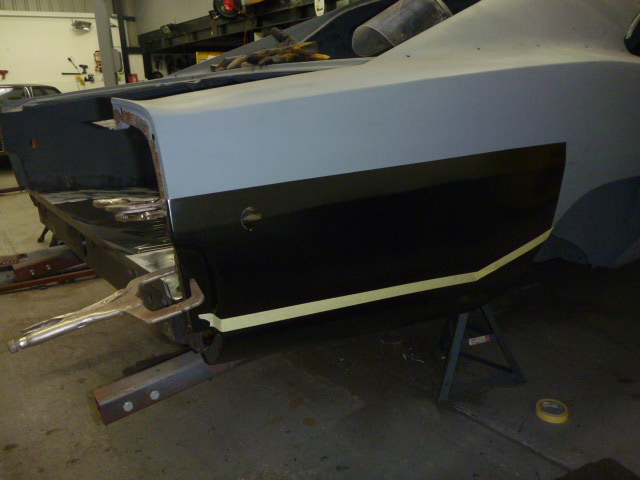

moded rear valence for exhausts narrowed tank so ex fit

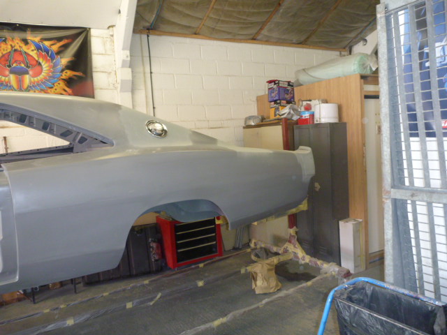

You're going to town there John, Is that the fuel filler in pic 1241, the exhaust is a nice idea. :thumbright:
mr m
Posts: 904
Location: SURREY

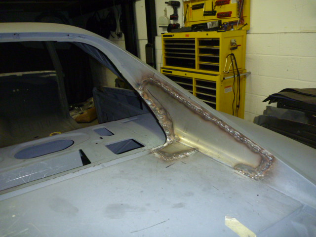

filler
Post by mr m »
yes moved it to roof pillar to clean up the body line & putting a bigger rear bootlid & quarter spoiler bit like the camero deck always thought the exhausts on the chargers looked sort of unfinished but that's my opinion
