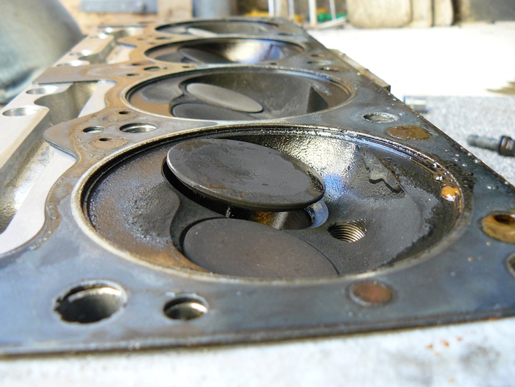

So... the tyres let go in 1st and 2nd, I couldn't get 3rd for a second, but floored it again when it went in and eventually crossed the line.
Thanks to my tell-tale tach recall, I found I'd hit 7500rpm (shift light was at 5800, what reactions!!)
The resulting valve float bust 5 inlet spring retainers. One had come out completely letting the valve drop into the piston, luckily only bending it.
GAME OVER :(
2013 July. The Nats. Bent valve.jpg (193.13 KiB) Viewed 4694 times

So, who do I send me head to for a new valve guide? :scratch:

Would stiffer valve springs/ titanium retainers be a good idea or would that just create other problems?
The valve springs need to be matched to the cam you are using so stiffer springs would only put unnecessary load on the rest of the valve train, ie pushrods, lifters, cam and the only result would be be a loss of horsepower and potentially cause rapid wear or failure of components, You would be better off with upgrading to 10 deg locks and retainers which hold in place a bit better. Titanium retainers are a good way of losing weight in the valve train in high rpm applications but I doubt you would see any benefit in your motor.
The best thing you could fit to your motor would be a decent rev limiter to stop you over revving it. ;)
