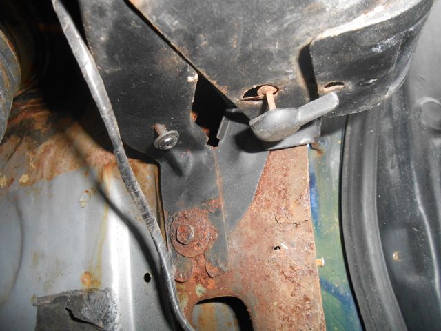

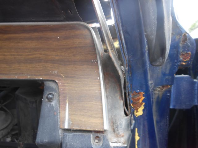

Having got the windscreen out, removed the instruments and most of the trim not to mention a years global production of filler, there is yet more evidence of the tinworm at work.
Is it sensible to remove the entire dash panel? Seems to be connected to the car by a few self tappers next the screen, a couple of bolts, one each side, in the footwell and what looks like a naff spot weld joining it to two or three layers of sheet metalwork. If this is sensible it would likely make repairing the panel rot in the footwell area much easier. This obviously needs to done right to preserve (recover?) structural integrity.

- Naff spotweld, probably Mopsr original?
- bee32.jpg (42.91 KiB) Viewed 1019 times
- Bolt attaching dash to body in footwell
- bee31.jpg (59.17 KiB) Viewed 1019 times
I'd take the dash out at this point .
Self tappers under the screen
bolt each side into the A-pillar
probably some stays to come off around the pedalbox/steering column
and it'll lift straight out . there should be no spot welds holding it in .
When putting everything back together, it's also much easier to reassemble the instruments , wiring etc into the dash, then fit the whole assembly to the car after it's done.

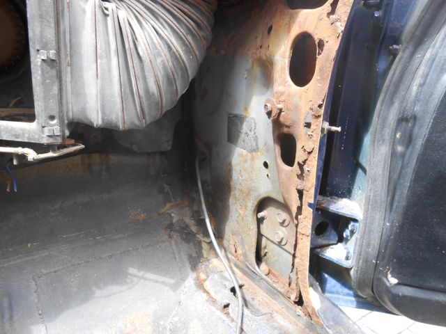

The lower part of the A posts, both sides, are well rusted, Could make up some repair panels but they wouldn't look that great. Does anyone know if repair panels or patches are available and where I can get them?

- Driver side rot
- Bee45.jpg (71.92 KiB) Viewed 928 times
- Pass side rot
- Bee44.jpg (57.31 KiB) Viewed 928 times

As for the rot in the posts, I've seen worse, you've done loads so far, just keep at it.............. seeing rust in all sorts of places puts you off easy, but in reality the patches are fairly easy to repair and they just become a longer list of jobs to do. Nobody is gonna see that one anyway
