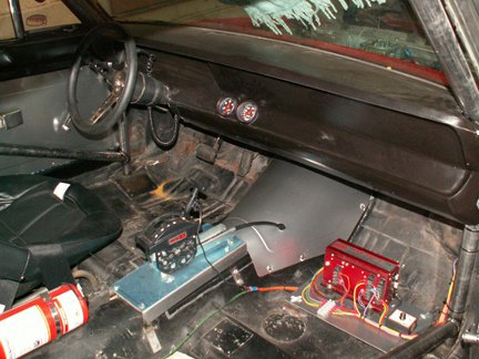

I ran a 7AL2 for yonks without out any issues what so ever. I did have one issue & got a replacement unit, but the fault was down to the MAP sensor giving symptoms of ignition problems.
I always had great 'spark' & no other associated problems, the only reason I went away from the 7AL2 was that I went to Coil on Plug.
I have run my 7AL2 with & without a crank trigger system & again no problems
I have read great feed back on the Digital 6, the same can be said for the digtal 7. The digi 7 gives a real lot of control & again I looked into these, but basically my Big stuff 3 covered most of the features which made it a redundant option.
MSD's like their own clean power supply & earth, mounting of the unit (mine was in car) is also a key factor, along with good vibration isolation.
On my experience, I would use a 7AL2 without hessiation

I've run 7al2 on my GTX, Cooky's Dodge & my Belve without issue the only thing is the coil gets very hot on prolonged use, I run a digi 6 on the Coronet and not had a problem running dizzy, and now crank trigger, also I use nearly all the features I'm very pleased with it, if I had the money I would go digi 7
