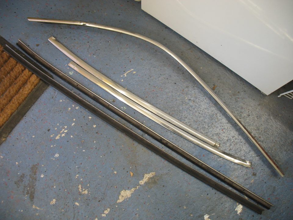

Posts: 5927
I've checked both sides and they are both the same, 9 holes for self tappers, an absolute joy to remove once the inner door trim panel is off.
Photo of the knackered remains is here.
If anyone has even half usable ones to keep me going to the Nats that would be good, or I might look to the states as there are some complete rubber kits on ebay for not bad money like this one.

Posts: 5927
Dave wrote:I don't remember self tappers. I seem to remember they clipped on.
Think I have some original ones in my shed. I will have a look.
Looked at the photo on the ebay seller site and the 70-71 fuzzies do look like they have clips not screws, mine are definitely screws.
Worth knowing that for a resto that there are so many differences, even between trims on doors.

Posts: 5927
thanks for checking Dave, My outers are the problem, as per the photo.
I have taken the plunge and ordered that complete 17 piece rubber kit from Texas. I will report on what it is like when it arrives. Whole lot came in at £219 posted which seemed good as it is all the door seals, and trunk seal.
