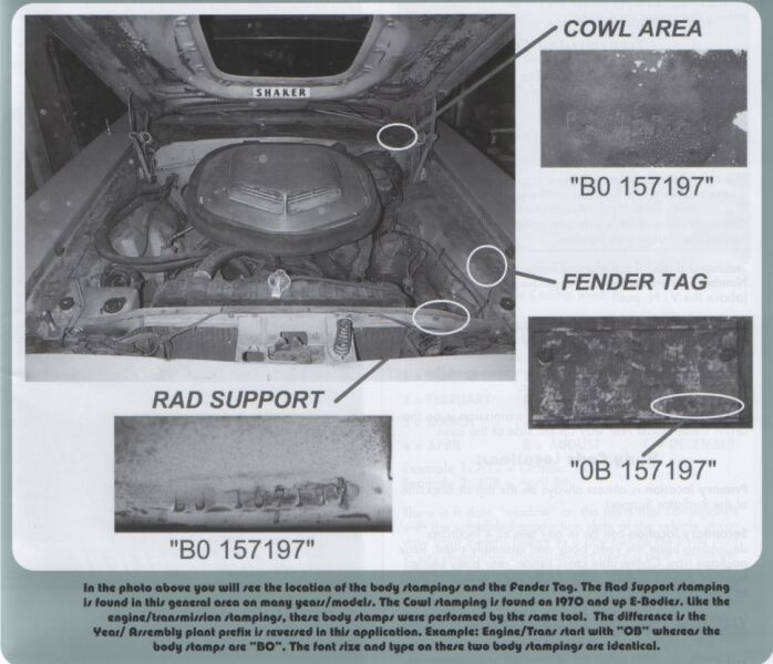

Where to find the VIN on the vehicle body/engine/trans
Post by Dave-R »

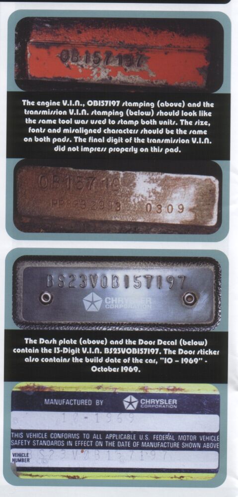

This is what the other numbers should look like.

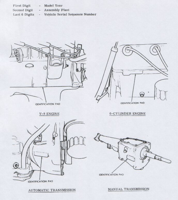

Here is the position of the numbers on the engine and transmission.

Making sense of the numbers
First digit
The first digit in the VIN is the car line.
Second digit
This is the price class.
Third and fourth digits
This tells us the body type.
Fifth digit
This is the engine code:
B = 198 ci
C = 225 ci
G = 318 ci
H = 340 ci
J = 340 ci six pack (1970 only)
L = 360 ci
L = 383 ci
N = 383 ci
R = 426 ci
U = 440 ci
V = 440 ci six pack (1970-71 only)
Sixth digit
This is the last digit of the model year (Not necessarily the year of manufacture)
e.g. 0 = 1970, 1 = 1971, etc.
Seventh digit
This is the assembly plant code.
The last six digits
This is the plant sequential production number starting with the number 100001. It is NOT an indication of the number of that model built.
Note
When the last 8 digits of the VIN are stamped into the body the first two digits are reversed from the way they appear on the dash and the fender tag. (see photos at top)

Numbers matching means body shell, engine and trans all have the same numbers.
The body should have the numbers in at least four places. The radiator frame, the cowl, the VIN tag on the dash, and the fender tag.
Some models may also have a number on the trunk opening gutter.
It is nice if the sticker on the drivers door edge is still there to as it has the VIN and actual build date (month/year) as opposed to the scheduled build date that is on the fender tag.

On my old Fury I found partial vin on quite a few panels,trunk floor,rear wheel tubs,rear parcel shelf were some.
