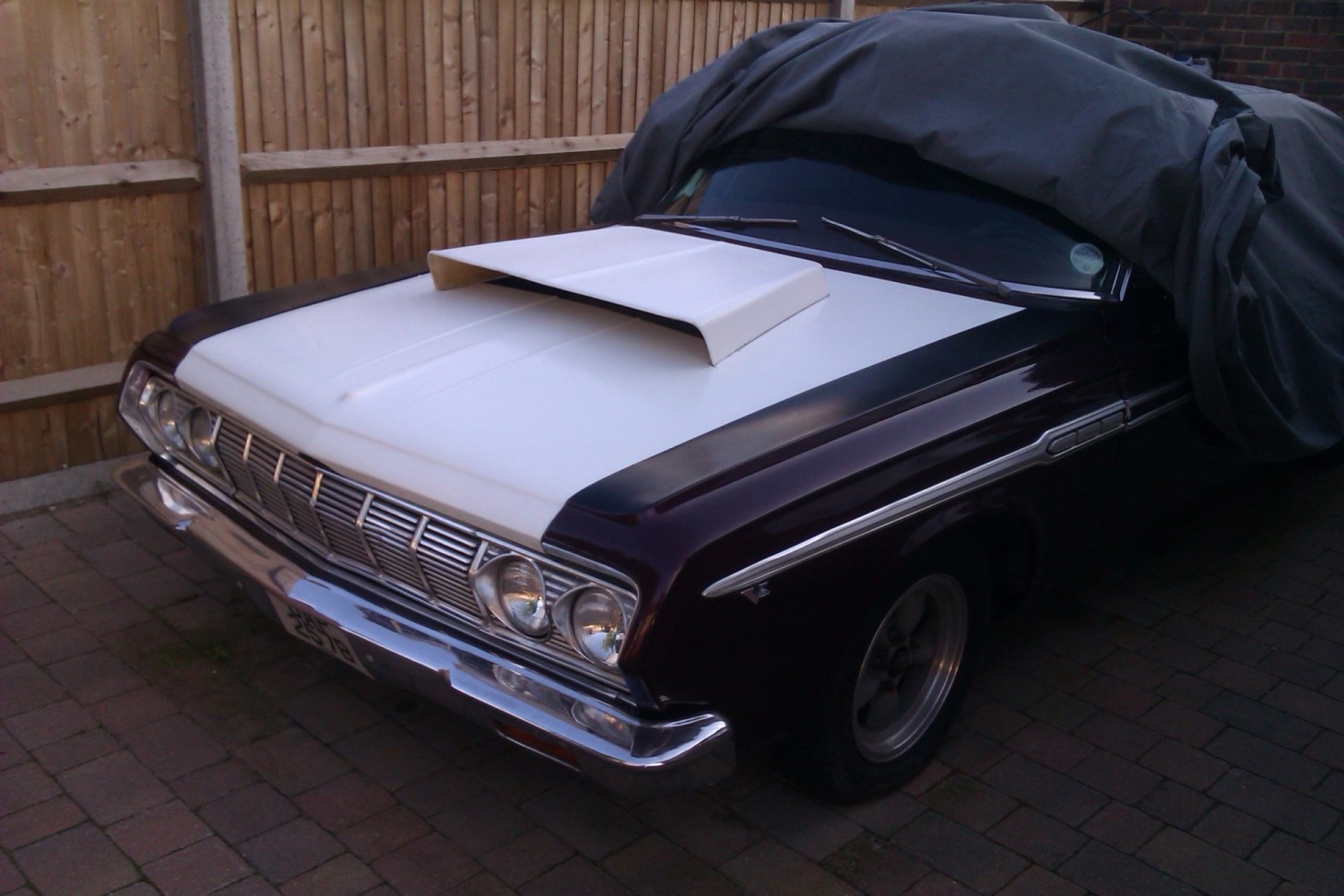

With my sons Cal Look Beetle finally finished I’ve started the new Engine for the Fury.
I ran the car a couple of times in 2012 before discovering a badly epoxy patched crack in the block found a new block through the club and ordered a stroker kit from 440 Source. The block is with a local machine shop and should be back in 2-4 weeks (a bit tight for Gary’s Picnic) other work on the job list is

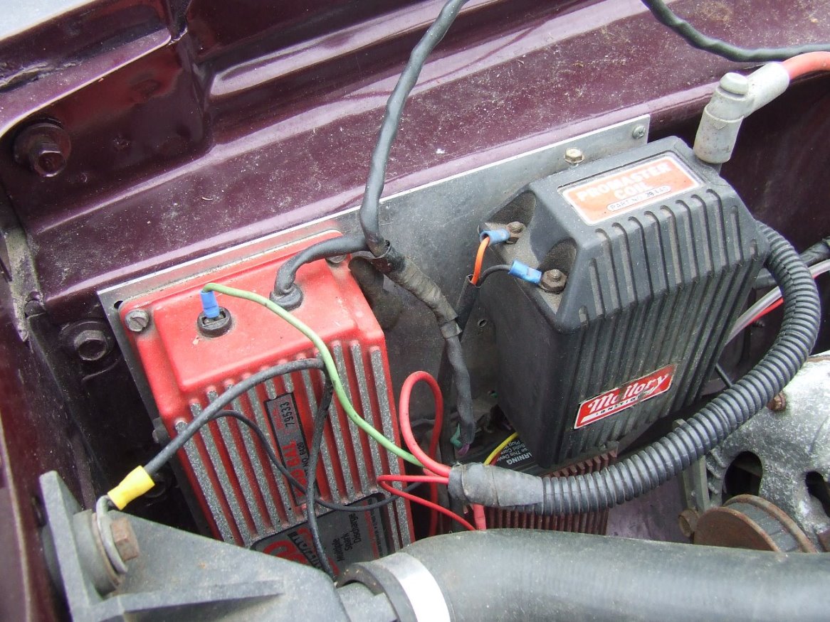

Tidy Engine Bay wiring
Fit MSD and Start /Retard box with a better fix than 2 self-tappers!
Fit grp hood
New torque convertor
Refresh Gearbox
The half shafts were fitted with the adjuster on the wrong side and not knowing if they have been swapped or been wrong since they were fitted I’ll replace them as well,
This is only a start, floor needs patching and I can see daylight between the wheel tubs and the body side but they can wait.

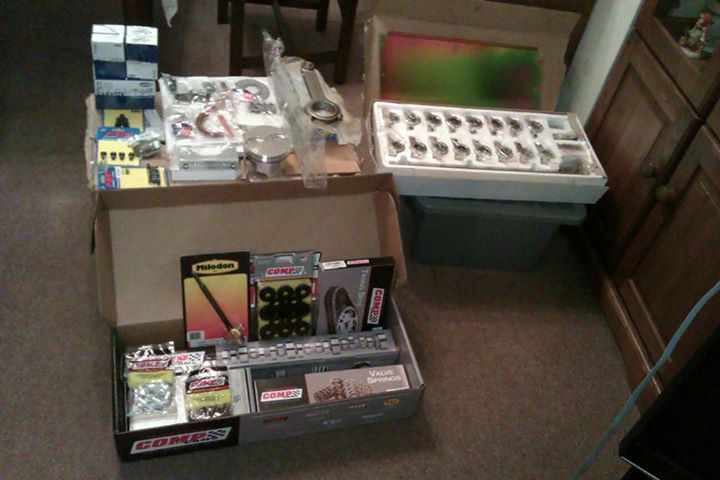

Very nice....and look at that big pile of goodies in the last pic! =P~

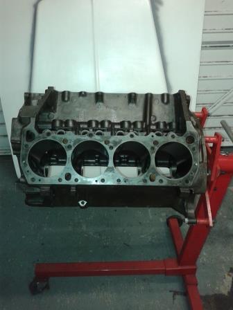

The block is now back from the machine shop, http://www.rolandalsop.com/

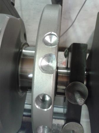

along with a balanced rotating assy. I emailed 440 Source about the balance I paid for before shipping, their tolerance is 2.5g, mine is now 0.2g ! I can't recommend Alsops enough and agree with Dave, balance over here, at least you can moan face to face :-) Also uncovered some less then accurate centring on the crank balance, at least no weight was added, to fall out later
