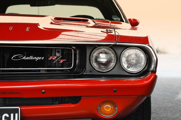

You can compare the round and flatter faced ones on this photo of my old car. The flatter ones are the outside H4s with built in sidelights.
