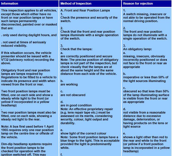

Took the Charger for testing yesterday. Chap comes back - 'Nice car, nothing wrong with that, but it's an automatic fail of course, with those lights'.
According to him, section 1 of the MOT manual requires separate white sidelights and amber indicators for post-65 cars. Fair enough, but not easy if the car only has a single combined lamp.
He was unimpressed by the twenty previous MOTs. They were just proof that other testers don't do their job properly :roll: .
(He also failed the rear indicators - apparently having an amber light in addition to the original red indicators is forbidden, they must be instead of. But this is an easy temporary fix).

On my Challenger I fitted headlights with sidelights as already said.
But I left them connected to the amber lights too.
However I also fitted a switch so that the amber lights could be switched off if I got any problems with a jobsworth MOT or Police Officer.
Best of both worlds.

I also got pulled by old bill in my Buick. Just change them and avoid the hassle. On my Roadrunner I left the combined amber indicator/ side light set up as just indicators: snipped the side light feed wire and wired it up to two small white side lights in the front grille.
I checked the constructions and uses reg in some depth. Front side lights can be as small as 1" square, must be symmetric etc.had no hassle with mine for MOT, old bill etc..
