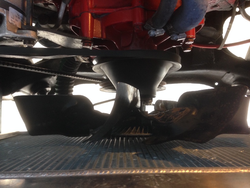

What is wrong with this?
Posts: 2338
The fan came from a Jeep, not sure what year but fits the viscus clutch set up.
It doesn't work as I thought.
Pushes air out of the engine area into the rad, so the car boiled over on trial run.
I have tried to turn the fan but still the same.
Posts: 5251
i would guess the fan blades are at the wrong angle for our cars
Posts: 8369
It's the wrong fan.
The one pictured is for a motor that turns anti-clockwise as you look at the front of the motor.
Your motor turns clockwise so you need one with blades that curve the opposite way. Turning the fan around won't help as you've already sussed ;)
Posts: 5251
like this ...
Posts: 14523
That's a reverse rotation fan I warned you about, I came unstuck in the same way which is why I ended up altering a plastic flex fan to fit the viscous hub.
Posts: 2338
I assumed that was the case, but when it said from a Jeep I thought it may be the same.
But there it goes you learn with your experience.
I am still looking for one so if anyone has one please let me know.
Thank guys, I knew this forum would help with all my questions.
