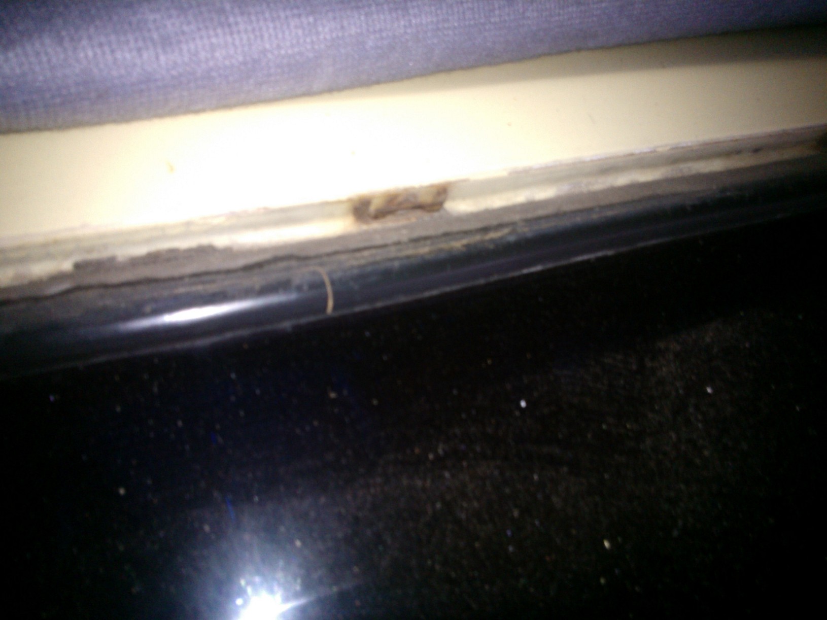

68 dart wipers and chrome trim removed. One wiper was easy and one hard to shift. Put a blanket on the hood because it popped of into the air. Pic of the tab attached. Trim was pretty easy to remove. I used the forked tool to gently prise the trim and the hook tool to slide along and pull out the clip forward until the trim popped loose. Ther are 8 clips along the top, 9 along the bottom and 3 each side. Now have to replace the windscreen but might leave that till the new year.
