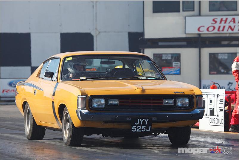

how wide are you wheels
20:1 ratio with 225 65 R14 on the front of my car was ok 195 is better
the 225 65 was about 8 inches across the treads on a 7 inch rim
the 195 is about 6.5 i think
this is what they look like
Hot Rod Drags 2010.JPG (63.91 KiB) Viewed 1402 times

I have tall and skinny radials on my Bee - 205 x 70 x 15. #no gaps.......
Makes the rears look even wider

Posts: 22262
No gaps at the top but it will never fill arch like a 235.
My Fenders are more slab-sided than a Charger.
Only other option is wheels with more Back-spacing.............
