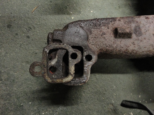

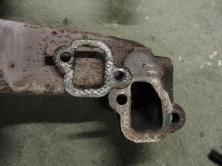

Now pulled the manifold on the pass side and I may have the wrong manifolds as the port shape is different, meaning there is very little gasket or sealing area at the bottom.
Does this manifold look familiar, is it a 360 maybe? The other side has the outlet at the back not the middle.
I think it may be time for some proper gaskets and fit the headers at the same time.

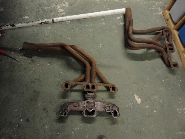

Posts: 5944
This is the headers I have, slightly different port shape.
