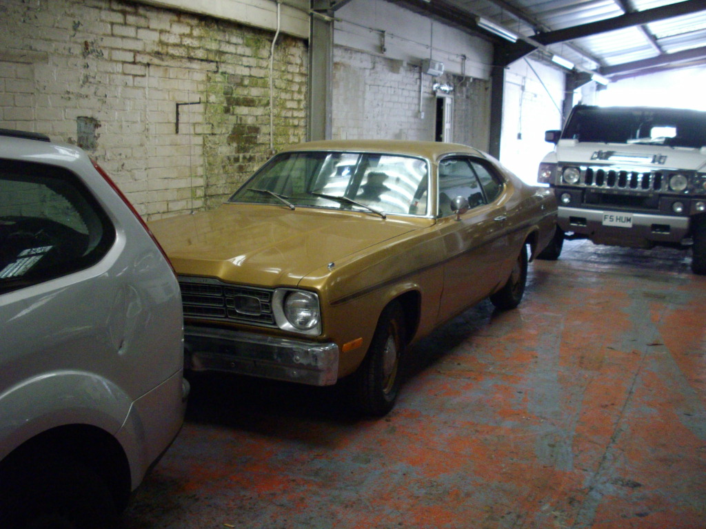

Yes new here ..Thanks for the welcome . I bought Don Scott,s gold duster a few weeks back , at the moment it has the slant 6 , 225ci , I,m looking to put a 318 in . Interior as well as body and paint needs doing but overall pretty solid .
1973 plymouth duster 051.JPG (245.55 KiB) Viewed 1676 times
Fantastic. I love that car.
Look forward to seeing its progress , and one day seeing it.

Thanks for the comments lads . I know Dusters are not everyone,s taste . Just looking at the picture that rear 14" wheel looks so little and skinny . I know it has discs on front and drums on back . I,ll have to take a look and see 4 or 5 stud ? Can anyone recommend the best place for wheels , I,m thinking cragar,s
Posts: 22150
Double check the bolt pattern - 5 x 4" (7/16" stud) or 5 x 4.5" (1/2" Stud).
As a later car you may be in luck as 4" PCD wheels are in limited supply.......
