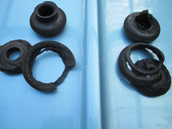

Just finished it,between other jobs.
Bushes totally shot and the wrong type. New original type now fitted.

latil wrote:Just finished it,between other jobs.
Must be something in the air, I'm doing bushes as well on mine :lol:
